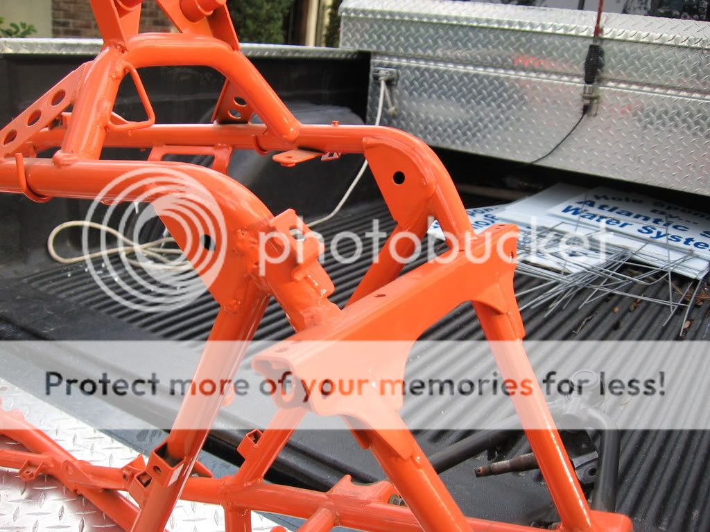

Only run the amount of coax you need to get from the antenna to the radio. There is no magic length that will make it work better so just run what you need. Also on the isue of grounding most people will run a ground strap of wire from their radio to the nearest point of ground. the point in the ground is to bleed off any excess RF and so long as your toolbox is grounded well you should be fine there. Also I assume you have an SWR meter to check your match after everything is setup just to make sure the antenna system is working properly. Good luck and welcome to the forum! 8)

A ground strap is something that makes a good (meaning constant, not intermittent) electrical contact between two things. It should be strong enough to stand any mechanical flexing/vibrations, and 'large' enough to handle the typical current flow. From there it's sort of whatever you happen to have handy, or the most of, sort of. From the equipment you listed, the current handling ability isn't gonna be all that 'big', so maybe some #12 or #14 wire ought'a work just fine. If those 'J' bolts on the tool box are making electrical contact with the bed of the truck, they will probably work just fine too. (Not really, but good enough. Add a ground, won't hurt a bit.)
Corrosion, or the metal deteriorating in weather is the biggest problem. Some metals 'rot' away faster than others. Unless braided copper is 'tinned', coated with something, it just doesn't last too long. The absolute bestest grounding conductor is basically whatever you happen to have, or can get without breaking the bank, you know?

Yeah should have mentioned what hotrod noted there earlier, you should never have to trim a 102" whip. You may also want to try it with an without the spring to see what matches better but when it comes to matching the thing ground is a key factor in how it will match. Also as W5LZ mention weather is another isue with grounding. Also not sure if it was mentioned before but you want to keep the ground straps or wires as short as possible. I would recomend using something like 10 or 12 AWG wire and conecting to the box using ring terminals and solder the conection into the terminal so weather will not couse it to degrade over time.

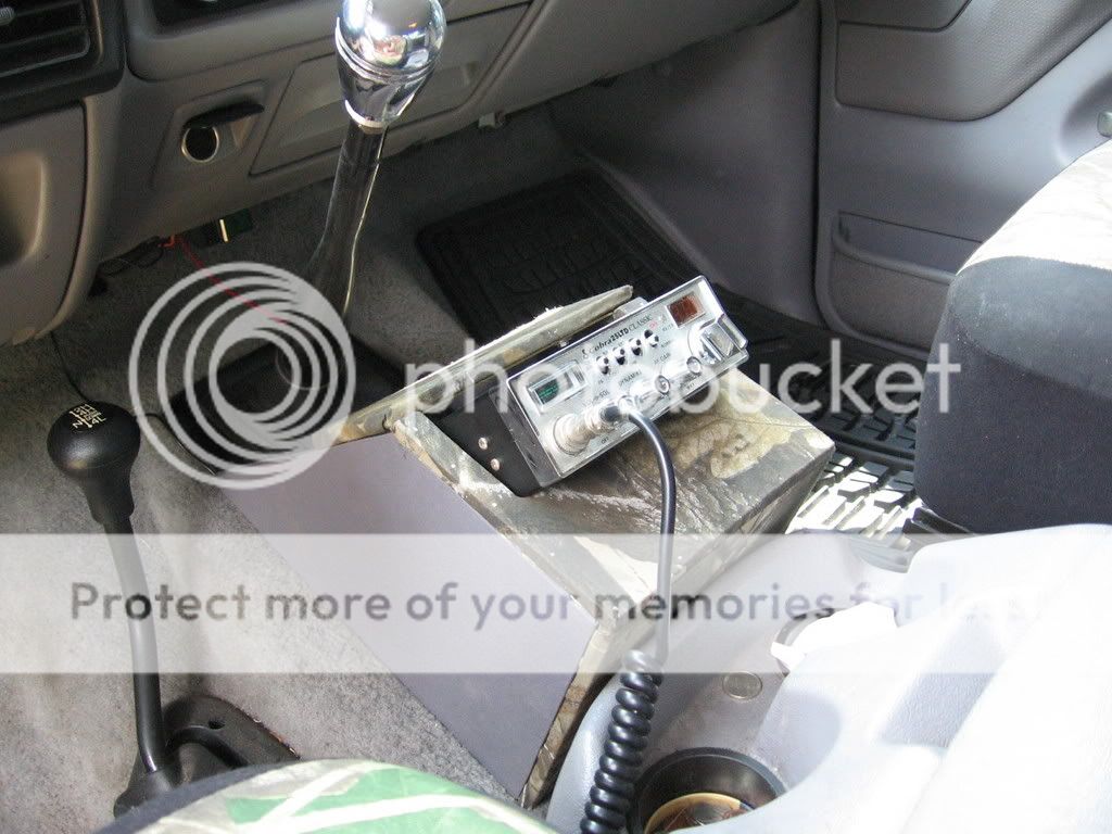

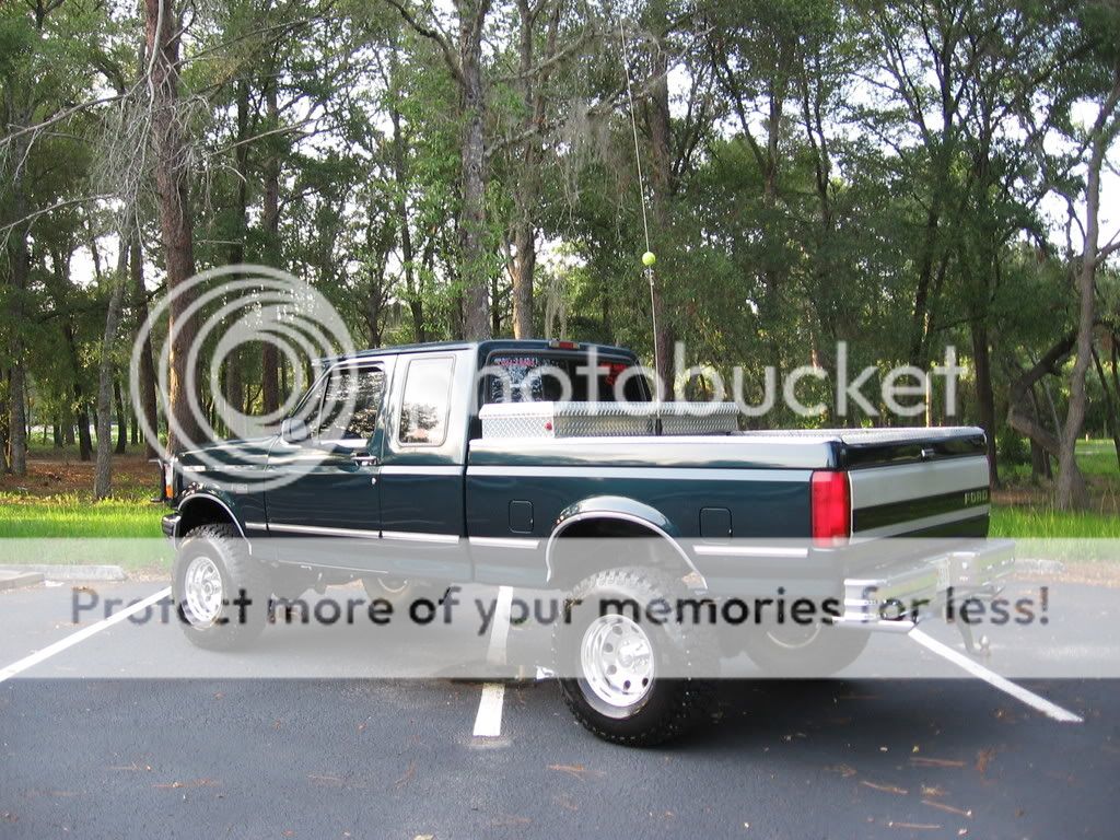

Here is some of my setup:
Here you can sort of see my mount. Im at school and don't have a better picture on my photobucket.
Here is another somewhat view.

I would not use Solid wire, it will fail after a while from vibration, stranded would be better, and even better yet, is some copper braid that can be stripped off the outside of some old coax. Make sure you clean off the paint down to bare metal were contact is made, then protect it from rust with a little paint after it is bolted down tight.
