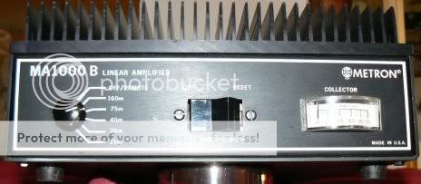

My Metron HF 8 device amp has a single bias adjust for the four push-pull pairs of transistors.
Am I correct in that if all transistors are perfectly matched or at least share the same batch code then this single adjustment is probably more than OK.
My questions is would anything be gained in having bias adjustment for each push-pull pair of transistors?

If you use parts from RF Parts, or get parts matched on a curve tracer (not just a hFE meter), then you probably will be OK.
I didn't pull the schematic up, but I'd put a diode from the CT of each input xformer to the bias supply to isolate each one.
Also, you know the #12 / XFORCE bias 'voodoo', I hope :)
