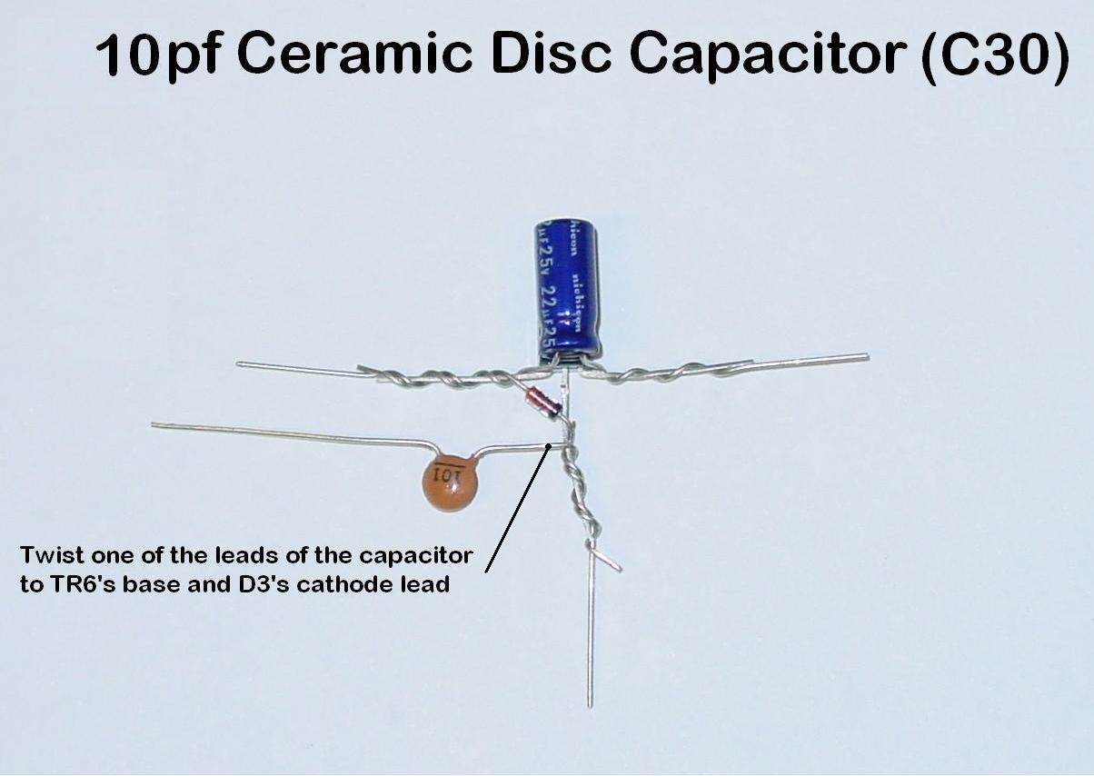

Hello,
If this photo works lol.
The cap is a 10pf
The diode is a IN4148
The polerized cap is a 22uf
The transistor is a PN2222a
On the left side of the pic is the negitive side of the 22uf cap with the diode, That solders to ground.
The lead on the left of the 10pf cap solders to the center of the input so239 connector or to the relay from the input so239.
The right lead (positive)from the 22uf solders to the relay. left lower terminal.
