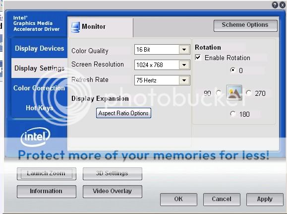

I found the answer to this by experimenting. The noise can be eliminated by changing the hz refresh rate. I have had constant noise on 38lsb. I would turn off the monitor and it would go away. I went into "display" in the control panel and clicked on "settings" at the top. Then clicked on "advanced" at the bottom.
Click the Graphics Media Acc. Driver tab at the top.
I then changed my refresh rate of the Monitor from 60hz to 75 and walla ! Noise gone !
If you have the problem of monitor noise coming over your radio give it a try ! :)

Adjusted the refresh from 60 to 75 and the buzz is 90% gone !
