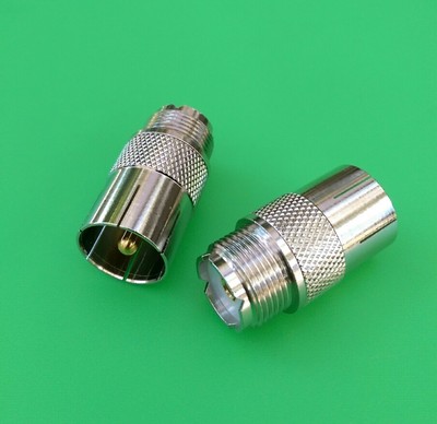

Last night before bed I decided to use the double male and double female connectors I already had so I cleaned every connection with alcohol and applied dielectric grease to every application and tightened them well. Then I hooked it to my Q6 Pro after cleaning & greasing that connector and was amazed at the SWR. Almost a flat-liner on every channel. So now I can't wait for the DX to get rolling.
