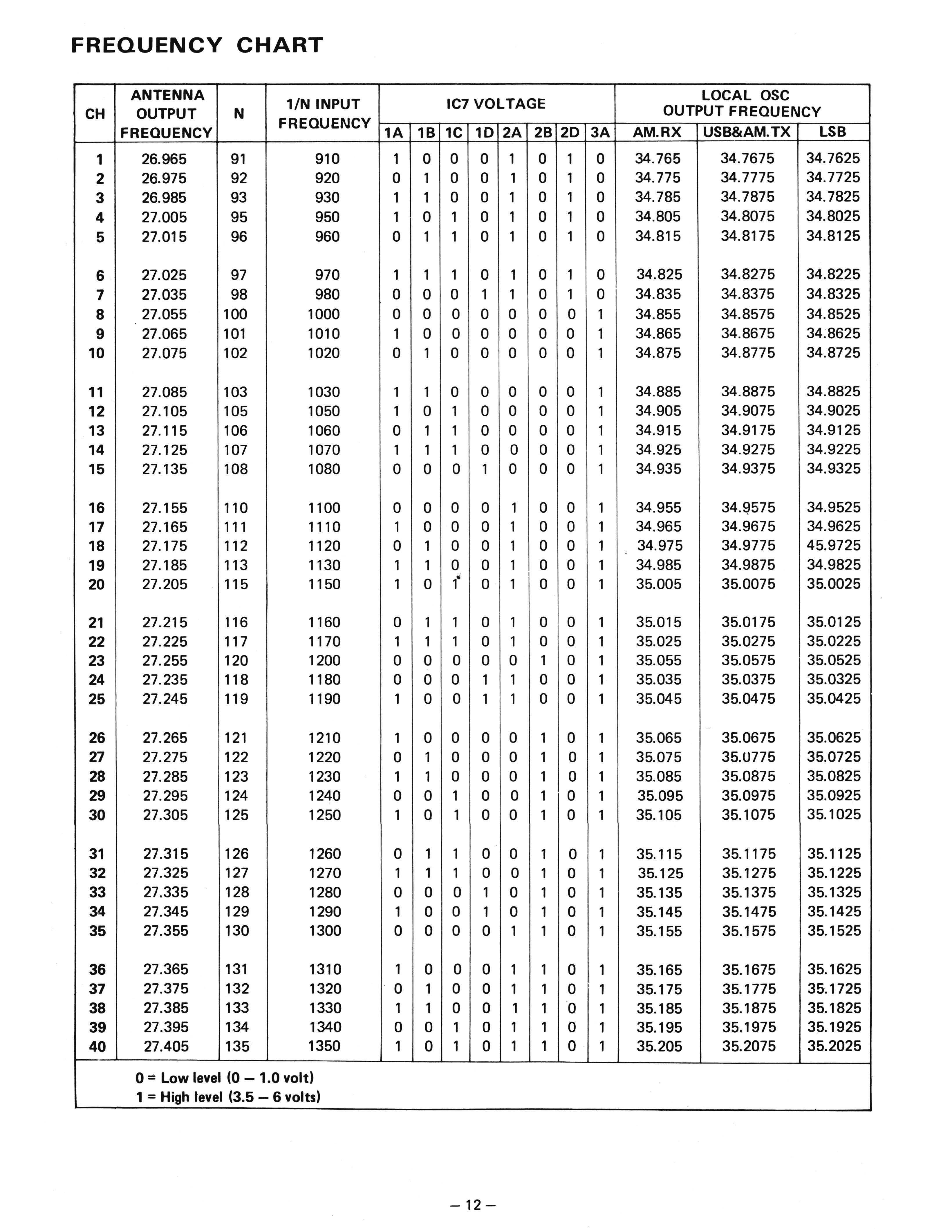

Ok got a little further in the troubleshooting, it's on frequency on some and off on others. And off during alignment as mentioned. Just got to figure out where in the stages the issue is.
Looking at the frequency chart from the TRC-449 service manual - looks like IC7 Voltage 2A might be the issue - matches up exactly with the channels I have that aren't correct.

So no voltage on pin 17 and so I decide to check the trace on the backside and sure enough wires running from the pins to the off/anl/nb switch, man I’m losing it in my old age, didn’t even see that someone had modded it.
I laughed out loud at myself....jeez. Now I can finish my alignment and I’ll have a nice operating radio :)
