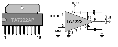

this is the Audio IC it sits on the side of the frame..
1. "Motorboating": Locate C162 or 62 (.001)on pin 5 of TA7222 audio ic and move to pin 4 of ic.
and if not look for a .001 cap on pin 5 of the audio IC and move it to pin 4 :)
im new to the fixin it world of cb..with the soulderside up are the pins numbered from front to back or back to front??
well i got good news :D and and bad news.. :( the good news is i found the cap on pin 5..when i moved it to pin for it killd the motorboat..bad news it also killed my audio..have carrier no swing.. thanks again
i didnt try it without the cap completly outof the radio i will pull it out in the morning and see what it does thankss
