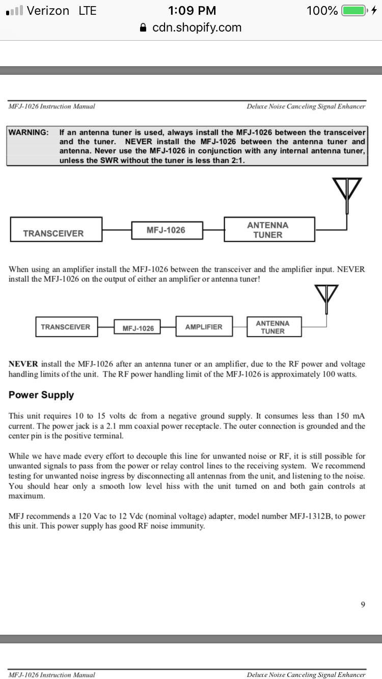

I take this to mean that, connect the antenna to the antenna spot on the tuner, then go from radio spot on tuner to the main antenna spot on the mfj 1026. Then go from radio spot on mfj 1026 to the connector on the back of the radio?
I just don’t want to fry this thing because I don’t have the money to replace it right now.
