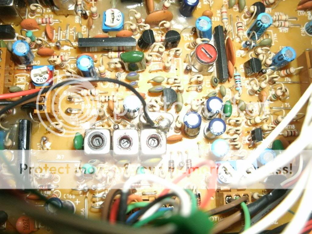

ok ill have a look at the voltages to see if there stable.. and I have a crystal that some one in the passed soldered a wires to it from the ground strap but on the crystal so I can suspect that crystal I think.. it was last that night ill just know USB is doing it so ill see if LSB is drifting as well that may help to pin point it so I can take this back to the tech....

so transmitting on USB is on the blink what can I look for?
guy had 4 wires soldered on I removed them but the 1. ill remove that one tonight it runs to an add on beep board.

The radio uses the same crystal in USB as it does in LSB; so that is not the problem.
Someone may have added ground wires to the crystal, that is in no way an indicator of its failure.
If I were to test anything at all, I would put a voltmeter on the VCO voltage and monitor it and see if it remains stable.

ok but that adjustment can next to it is the TX for USB and the plastic inside is melted a little bit.
Would you say it is worth a shot for $4 part? I can order it and have it on hand if the shop wants to through it in.
I would say that if it were of any consequence to the guy that aligned your radio, he would have already replaced it before he aligned it. Replacing it now will in no way change your radios drift problem one way or the other, other than throwing the radio out of alignment once again because it will then need to be re-adjusted.
