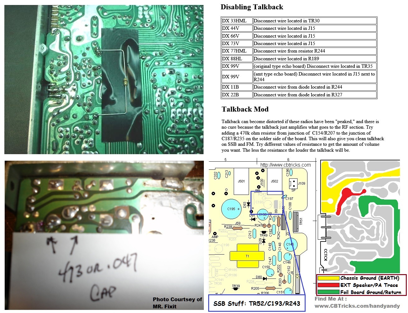

Does anyone know how I can make a variable TalkBack on a Galaxy 66. I have tried to put a variable pod between the wire going to j15 but it didn't work anyone have any other ideas what could I do

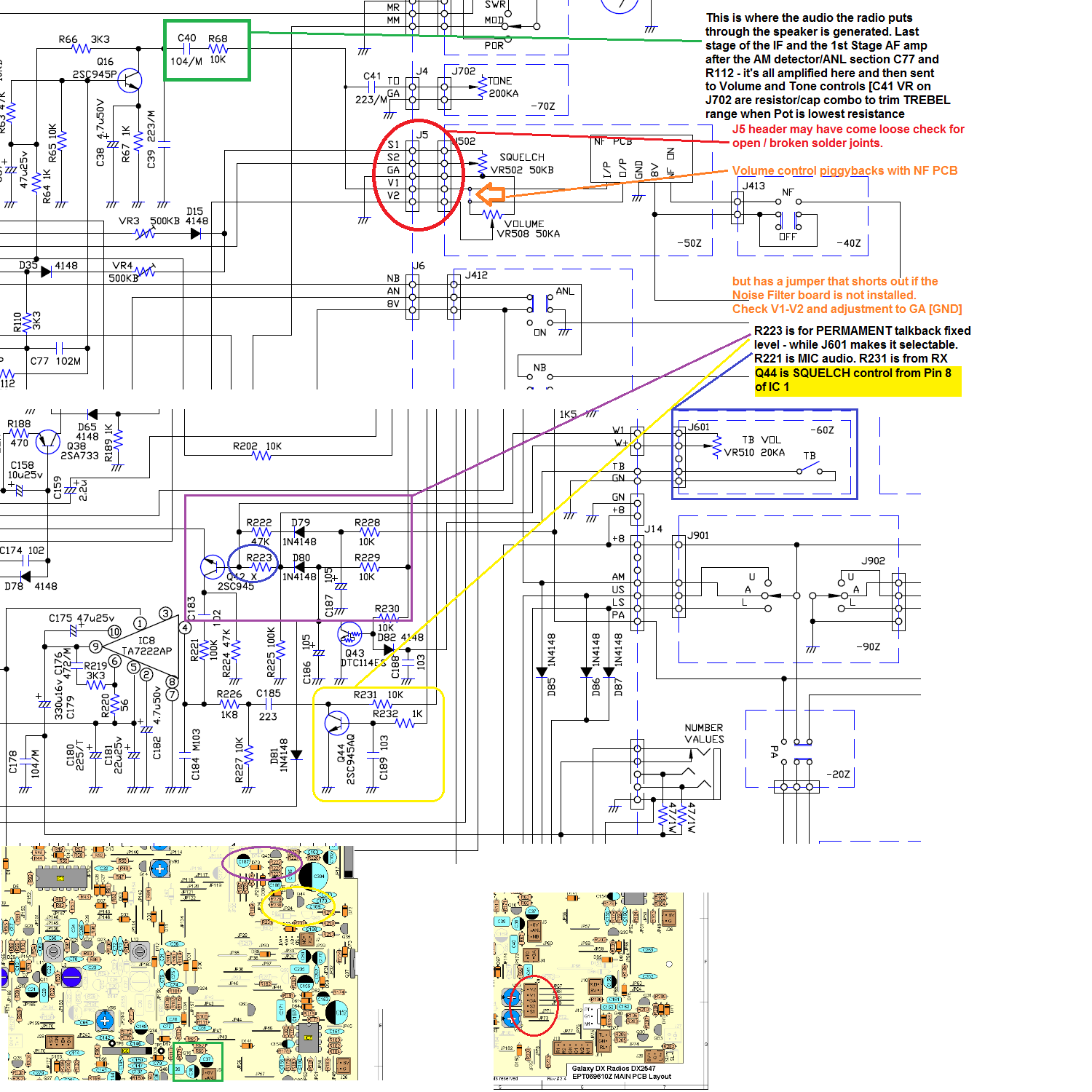

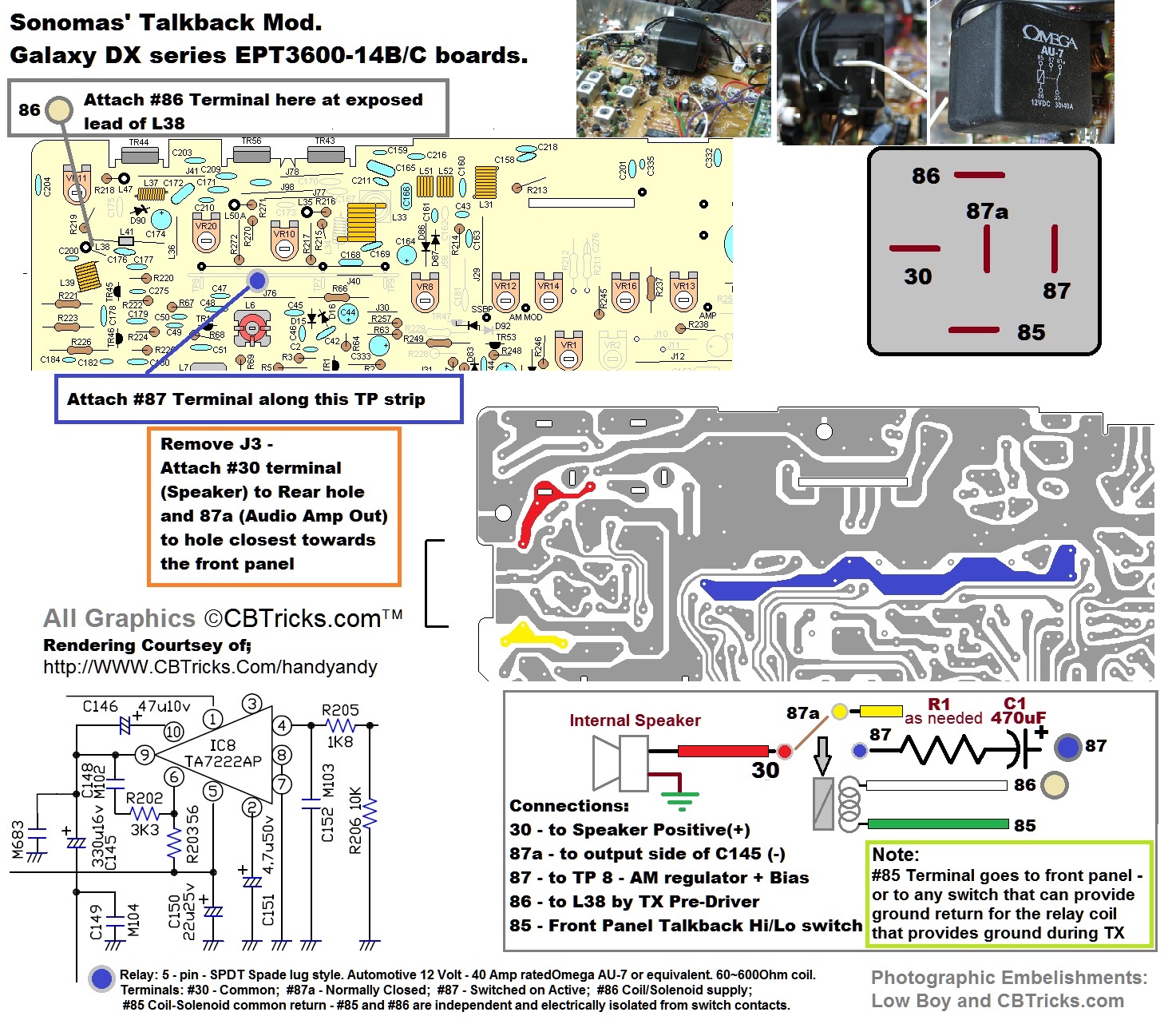

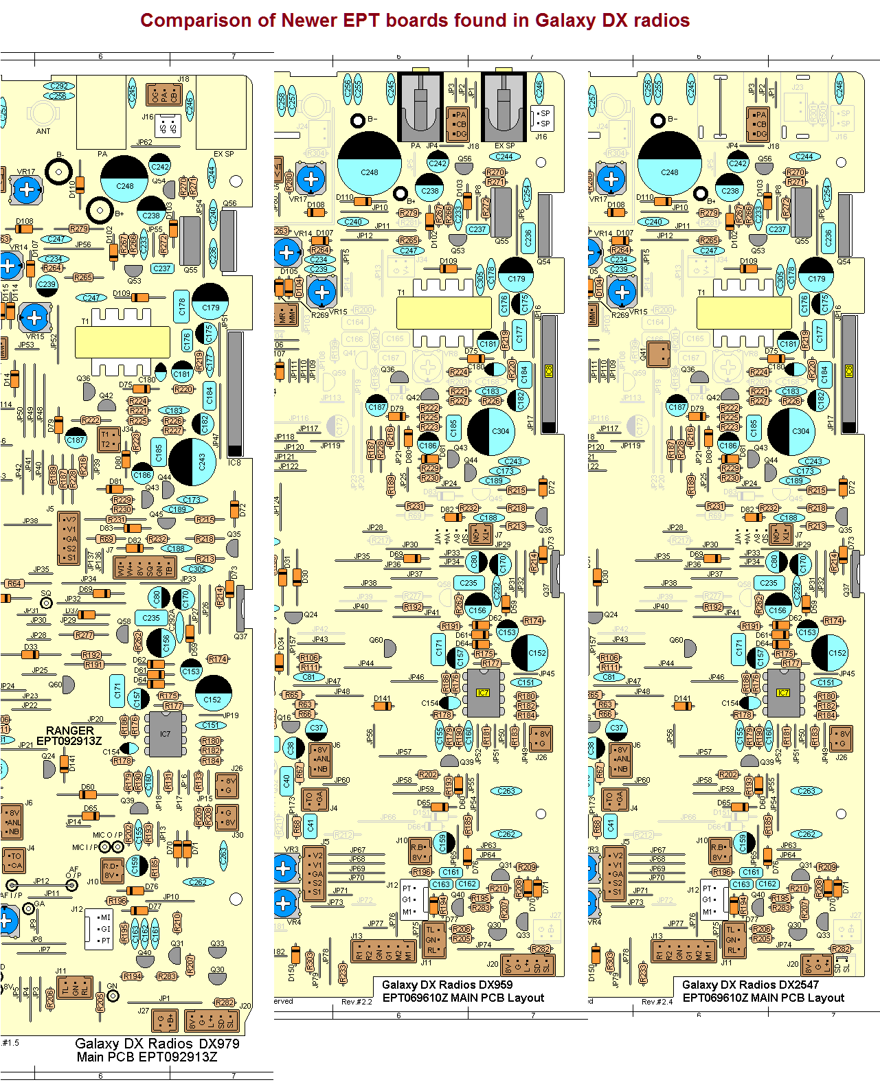

Hmmm...
Considering that nearly every month I was on CB Tricks _wow_ I'd get emails or answer posts about how to install, change or explain talkback to someone...
Boy, I went thru my archives and found a LOT of those reworks, re-do's an explanations I did graphics for from people Like Sonoma, Mr. Fixit - Lazarus amongst others ...
So even though there are a lot of variants, the board you speak of can be either an EPT3600 - which would be a Mr. Fixit or Sonoma, onto a Ranger EPT6900 series board, similar to the 3600 with more bells and whistles but still basic blocks being the same only in a different wrapper
  • - you are more that welcome to look thru this "pile" and figure out which of any can apply to you.
If you can - I'd like to spare the rest of the group in having to waste a lot of time searching this archive just to find a mod that suits them - PLEASE POST YOUR RESULTS on which graphic was more suited and worked the best for your application.
Thanks!

Thank you alot I appreciate it and I am going with Sonomas mod and I will definitely post the outcome which will probably be next weekend because I have to order a relay
