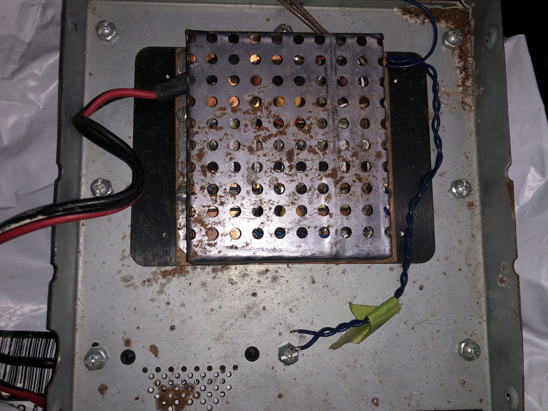

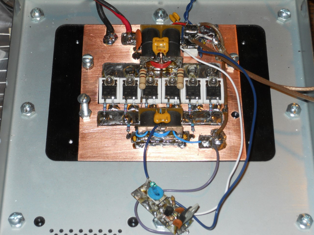

I built a cheapo MOSFET amp over a decade ago to experiment with on a 959. Haven’t used it in years and it got kinda rusty laying around. It was AB biased, small board in front of the input transformer, and a small keying board by the relay, tried to keep it compact. No photos of it on the radio as the radio is in pieces in the basement somewhere, was not my main radio and was just used for experimentation. This was all just for fun playing around so don't be too critical, it was meant to do about 100w peak or so. It worked okay. I don't think I had any ferrite / choke to do the power lead at the time, but again, was just something to play around with.

Just found this pic when I was working on it, a little less rust. Use a variable bias to dial it in, then set it fixed if I recall.
I dig that. i remember that 6 fet schematic floating around cb tricks forum years back. never made a move on that one
Yeah I tinkered with a lot of these back then in junk old amp heatsinks, biggest I did like this was 8 520's, 4 parallel per side, I have a photo of it somewhere. I liked the 4x520 amps for low power / reliability and used one for years.
