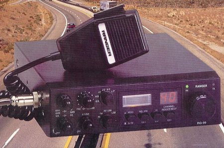

I've never heard of a Galaxy RG-99. Ranger, yes. Got a pic of it?
Sorry been away from the computer for a few days . I sure feel stupid right now , it is a Ranger . I must have had Galaxy on my brain when posting this . In any case i replaced the 4558D and it started breaking up just over 3 hours into use . Back to the drawing board i guess . Sorry for the Galaxy / Ranger mistake .
