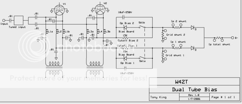

I once tore the whole bottom out of a finished amp because Tony advised against using the CT as the cathode return, the need for dual filament transformers and, triode control boards versus 33 volt @ 1 watt (x100) zener diodes.
This is the one that was past the prototype stage, I delivered it to an associate and, he "helped" me find out where the weak points were and, what needed to be reinforced; this is part of his warranty service. I was on the other reflector trying to come up with proactive plans to prevent downtime.
I will never build a multiple tube amp again; dual filament transformers, bias circuits and separate grid and cathode metering for each tube is insane. Just get a bigger tube instead of trying to fight with multiples.
