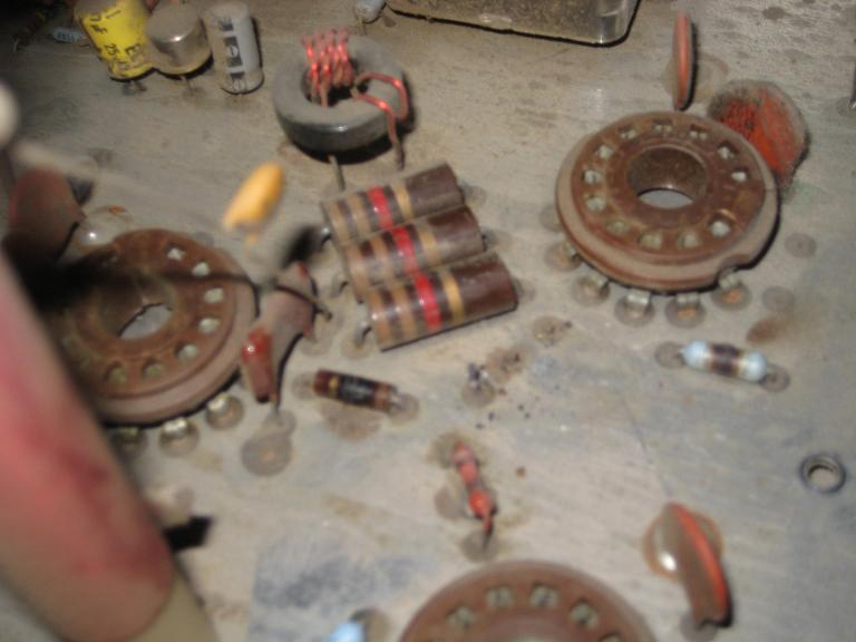

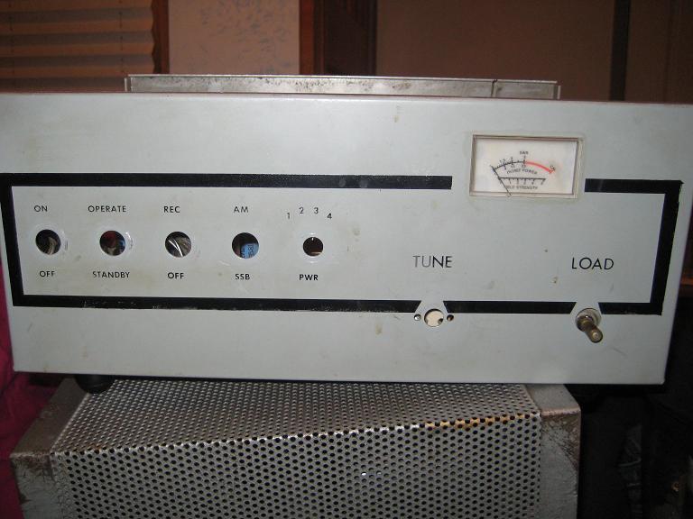

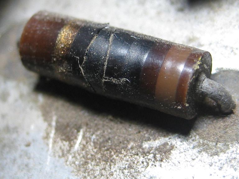

This has actually been a great amplifier until lately. It contains 3 30kd6's and is transformerless. The tubes were getting pretty flat then suddenly it popped. I have a total of 4 resistors out. They are the same in pairs and I have identified one pair but no luck with the others. I removed one hoping I could see better a color band maybe but no luck.
Anybody know who makes this amplifier or has one like it. I have actually seen several sell on ebay over the years.......which I could contact somebody now that could tell me the resistor color bands. I have identified brown as the 1st band and gold as the 4th. Im lost on the other 2 though.
Thanks

If I remember correctly this was a Crusader 300 Base Amp. Not the best of designs, some say even an electrocution waiting to happen due to its lack of a transformer. I had one many years ago, It died, I fixed it, then got rid of it....

I have never heard of a crusader but I know what you mean about the no transformer haha. I am actually very partial to this amp though and would love to get it going again quickly. There is literally nothing to them if I had the schematics there would be no problem.
i had one of those transformerless amps ,it was mint .lost it when i got hit by lightning.i think just the keyup resistors went or something .i forget who made those ,for tube amp questions get ahold of "alan" at tubesplus.com......he is very helpfull and can probably even tell you who made that amp.i doubt he work on it though.nobody really wanted to touch mine because you gotta take the whole chassis apart to get to the solder side of the board ,theres no other way.and theres a electrocusion hazard as well because the chassis is hot on those i was told.
funny thing was when i first bought mine i went to pick it up at the ladies house and when i picked it up i nearly threw it in the air it was sooo light.i was expecting to pick up a heavy amp ya know ..lol..
oh...and those tall caps in there you see,they are holding a big charge ..enough to lay ya flat out you get bit by that amp.so be carefull inside that thing .it can hold power for days i think unless you discharge them.
ps-i think mine was called the footwarmer 300
I appreciate all the help so far guys! I will call tubeplus also to see if I can get some more help there. You are correct about removing the entire chassis though which I already did. I just need to swap out these 4 resistors and put the new tubes in it. Be nice to have my little base amp up and running.

I was actually always told this amplifier was called a Barefoot 300. What is actually pretty awesome is I found another person on CBradiotalk.com that has the same amplifier - saw it in a picture. He sent me some pics of the inside he had on his computer and it is identical. He also said it was called a Barefoot but its actually supposed to have (3) 36KD6'S in it. Might be why the resistors finally went out too......
I just need to identify from the color bands what resistors are in the pic he sent me but when I blow it up its very hard to tell. I did notice that all 3 resistors in his amp appear the same and one of mine are different. I am sure somebody probably replaced one at sometime. I'm going to try to identify what the last remaining one is. Maybe its just a newer resistor but the rating is the same?? I hope!

I would really appreciate if if you could find a schematic! I have been talking to alan at tubesplus and he doesnt have the full schematic for this unit but has been extremely helpful. I am going to try to lift the one remaining resistor and ohm it to find the value. I cant tell looking at it what the value is and I hope its still good. Its obviously been replaced before though so hopefully the correct one was put in.....

The resistors are 10 ohm, 1/2 watt. Band colors are as follows, brown, black, black. The ones in my box are silver on the last band but that only indicates the tolerance of the resistor.
I bought one EXACTLY like this a couple months ago from a friend who had no idea what it was... paid 80 bucks for mine and it works flawless. I'm unsure of the brand name, but there's a few things that are noteworthy about this amp.
It has its own built-in 20W dummy load. You'll notice that there's 2-25 ohm, 10 watt power resistors in the back. They are tied parallel.
This box uses a diode-capacitor follower circuit as a voltage multiplier right off the 117V AC line, eliminating any need for a transformer.
I also have reason to believe that it is grid-driven on the tubes. This don't appear to be the standard grounded-grid, cathode driven setup. Driving the tubes through the grids achieves a bit more linearity than grounded grid configurations.
The amp I have works fantastic, looks good on the scope and very little splatter on AM or SSB. Below is a couple pics.
If you need help with parts identification, feel free to drop me a PM. I'd be glad to help you. Cheers! :thumbup:
