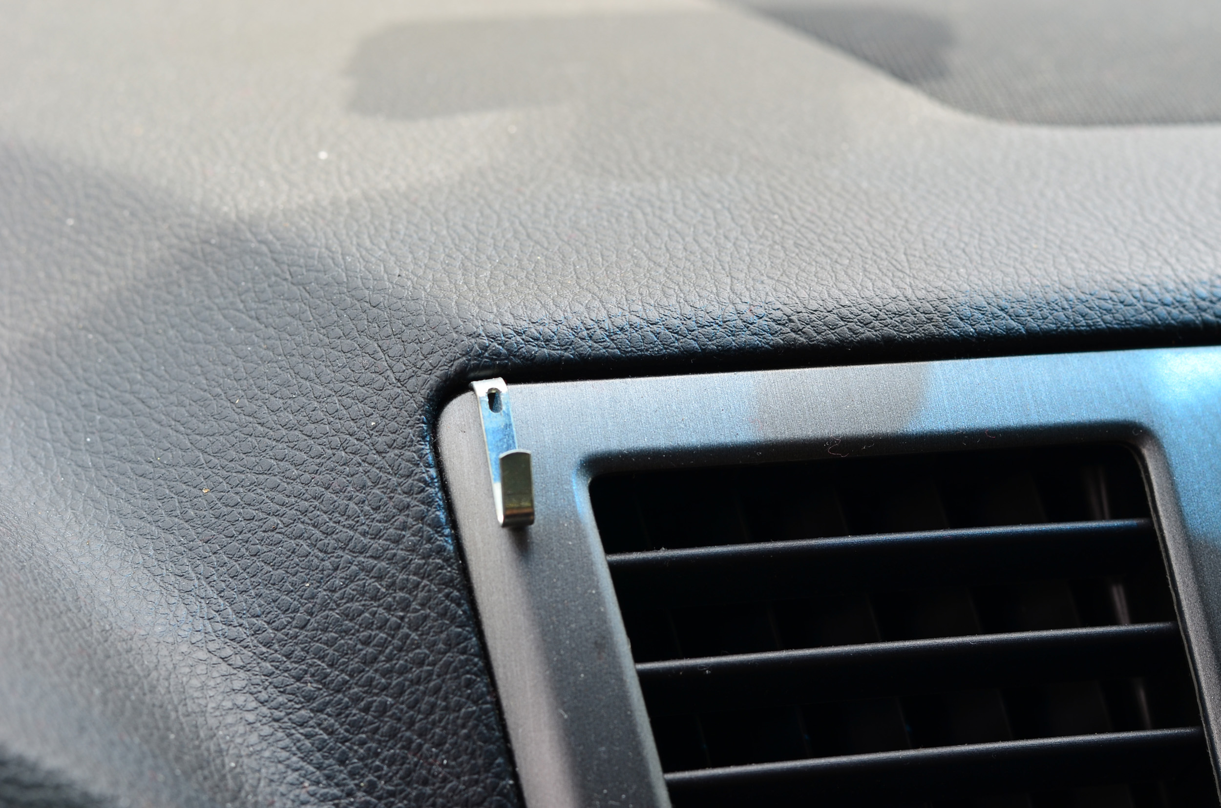

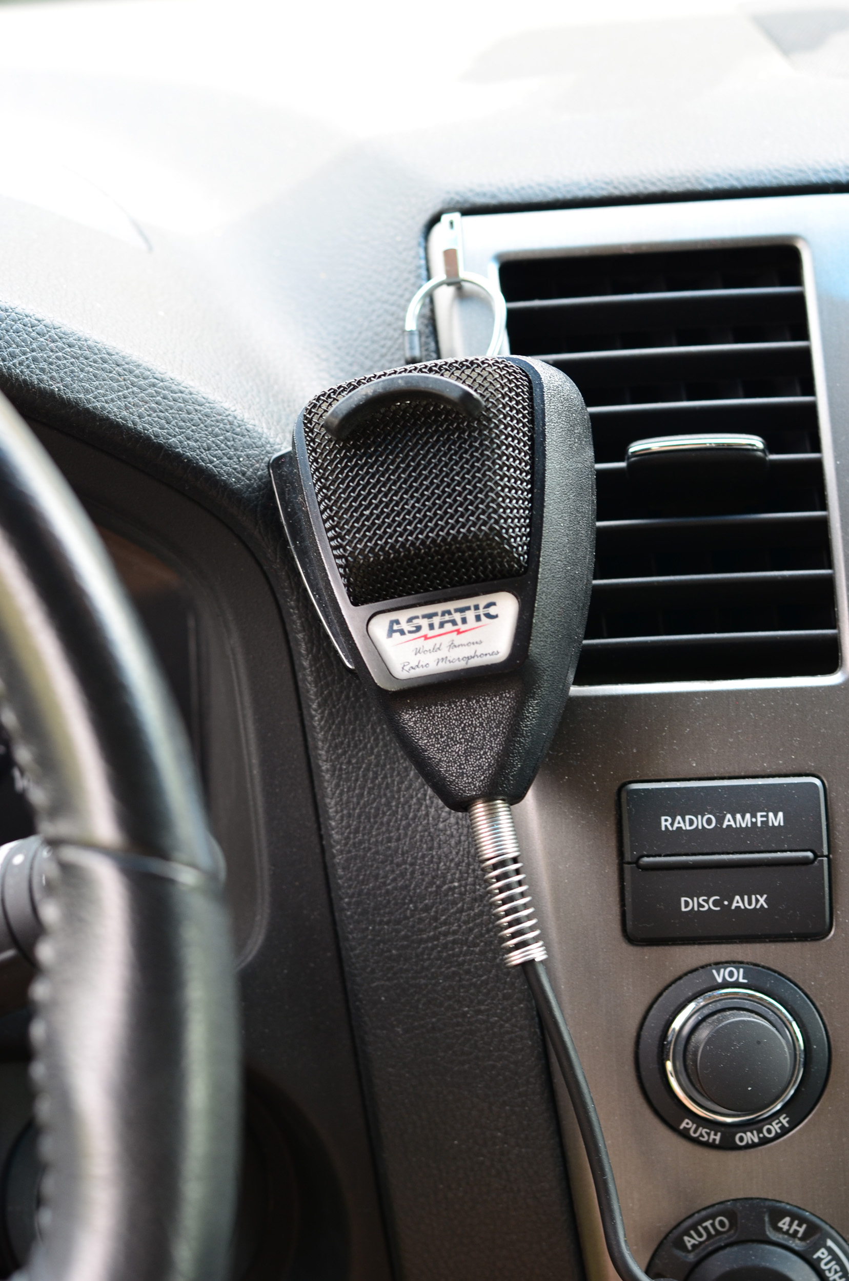

I gave up trying different ways to mount a standard mic hanger without drilling and got a little inventive. The cure was a standard wall picture hanger hook. I merely bent the back part straight and stuck in behind the dash trim around the front console. The molding holds in very securely.
