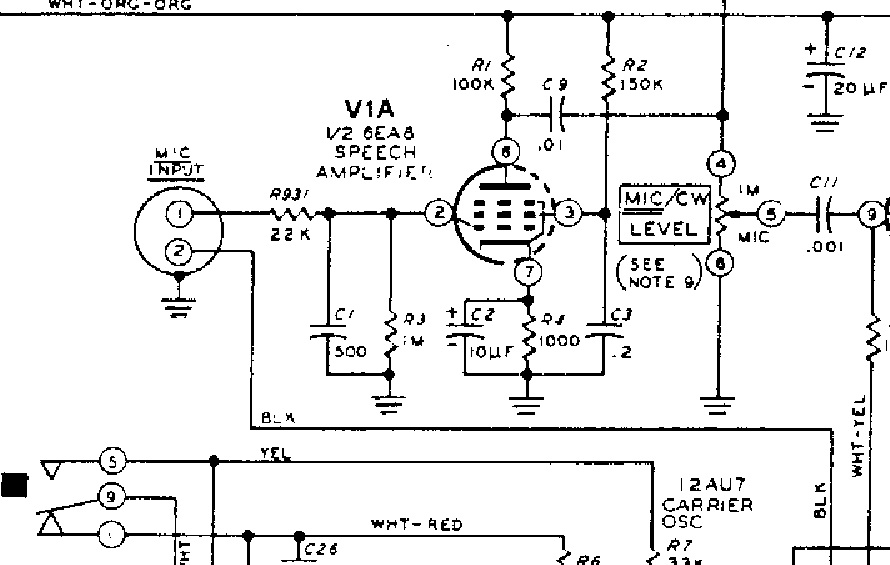

heathkit hw100 looks different where mike plugs in.looks like a two wire of some kind.what did the mike plugin look like and how many wires does it use.also need wiring digram.
Pin 1 is Audio.
Pin 2 is Key
Shell Is ground.
relatively common two pin mic connector....
