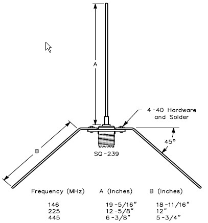

If you just want to make a 1/4 wave vertical, make one out of a SO-239 like this:
It's so cheap and easy a caveman can do it :)

Thanks for the link, very useful.

I wanted to say again thanks for the link. I actually made 2 of the 440 antennas, the 2nd one worked great and still does.
