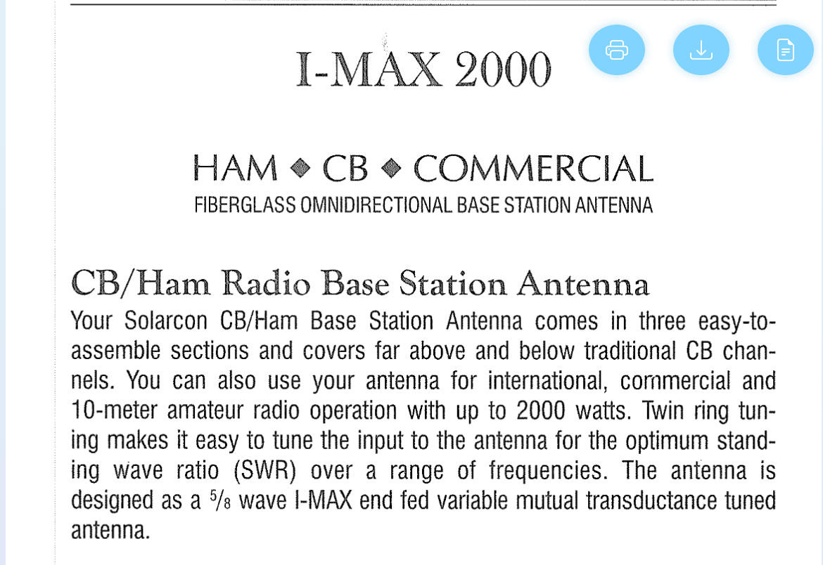

I have been comparing the Imax 2000 vs the Maco 5/8 wave antenna. Both have 5000 watt pep capabilities, just wondering what kind of success any of you have had with one or the other? I like that the new 2000 is longer and has more Bandwidth. Anyone have/use an Imax?
