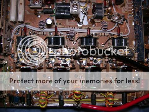

More stuff out of my messenger amp stash. Here i share with you the first pics published of the inside of a messenger M1500FR Turbo.

ground
Take notice on where that big 4ga ground wire is grounded to inside the amp.....thats right on the pill strip! First time I have seen that.
I noticed that, suppose it's for the best with that printed circuit be chopped up so much and since electrons flow from negative to positive the amp would have to draw current through that setup.
That is where it should be grounded. That is as close to the current source as you can get. Here is an older 6 pill that was done that way. This was built in the late 90's.
interesting pics pumphouse, the m4v uses the same ground scheme,
Nice! You know whats funny? I have a m4v that does not have that ground scheme. Ill post pics soon
Damn peek, you got some sweet stuff also! I like your combiner scheme. Clean.

On another note... I've always liked Messengers. The first few amps I built years ago were Messenger copies. I've used messenegers passive bias design a few times with decent results.
I've never thought of feeding the neg dc right to the emitter ... but I'm going to try it next time.
