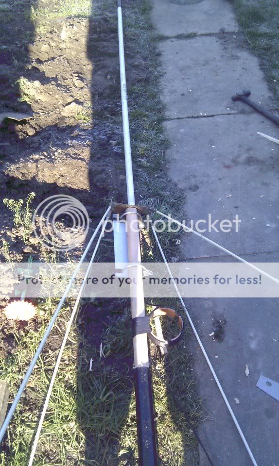

i dont see a half wave as a groundplain but you can read online about it only needing short radials if any, like 2 feet is all but yes isolated

This antenna isolation topic comes up from time to time locally as well. I run a Sirio 2016 aluminum vertical antenna on a few sections of military FIBERGLASS antenna mast. The non-conductive fiberglass mast is mounted to my wood framed chimney that in itself houses a steel fireplace flew that goes down to a fireplace about 30' below. This puts the base of my antenna at 36' above grade.
So my aluminum antenna is not mounted to a conductive mast, but may couple capacitively to the steel flew pipe about 4' directly under it. The Sirio 2016 is somewhat unique in the fact that it has (16) 24" ground radials at it's base. For whatever reason, this set up has served me very well for many years now with low receive noise and a good RF take off angle.

very popular and FWIU durable antennas . played with four 1/4 wave ground elements vs eight 1/8 wave ground elements and got better performance with full 1/4 wave ...... results do vary . would be interesting to mod a 2016 to using 4 1/4 wave ground elements and compare to it's stock version ..... but the smaller ground elements allowing a smaller footprint is attractive to some folks and full size elements won't work for some folks installs .
looks like it's up there pretty good , should be doing very well for you .
