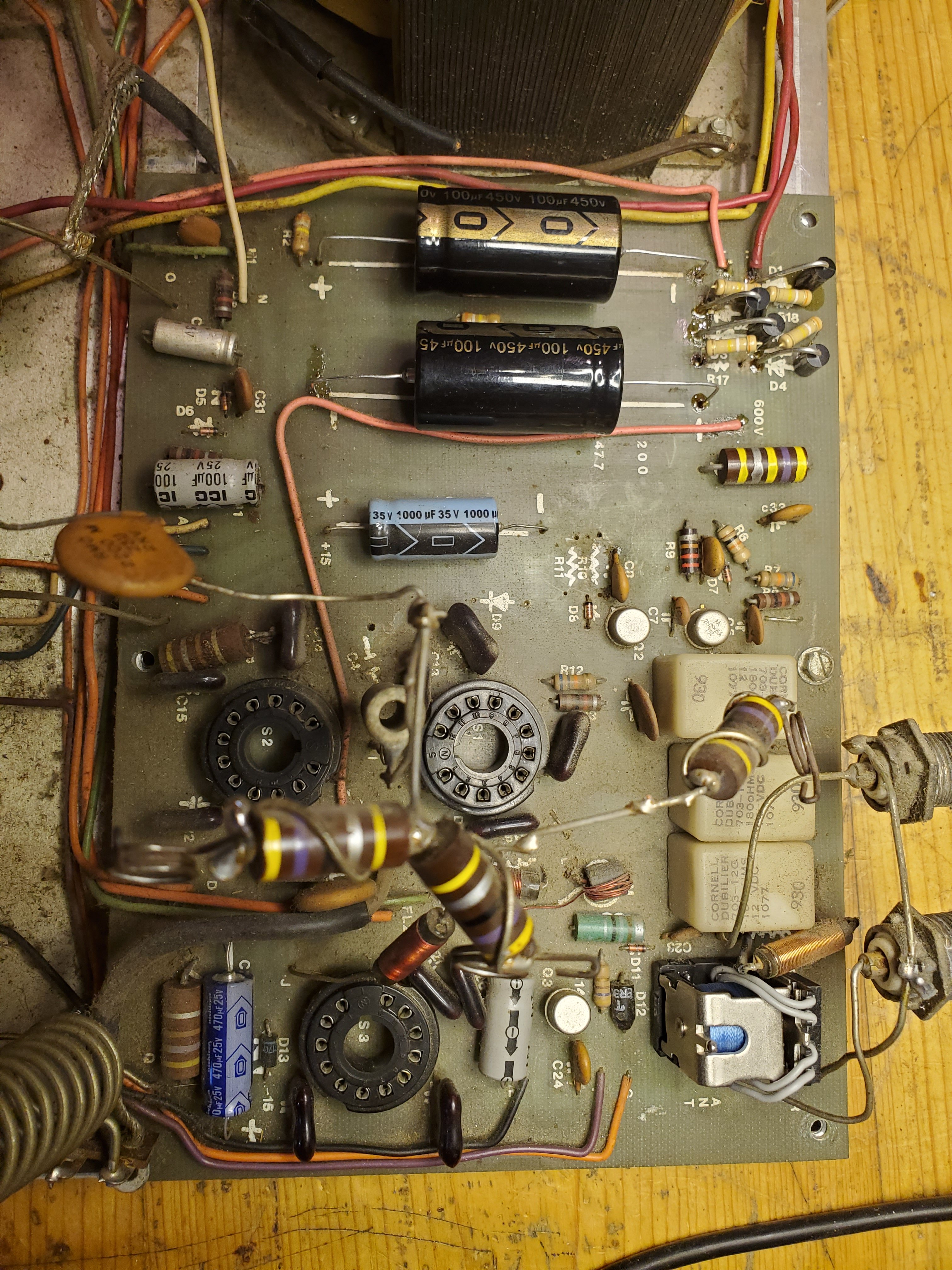

Hello, I am working on a kenrich eagle 200 that a buddy gave me that needs some help, the only schematic that I have from a member on here I believe is fairly blurry and I was wondering if anyone could tell me the value of the resistor at R11 ? Also possibly if there is a diode at D9 ? Is it supposed to be a 171 and if there was supposed to be a cap at C4 ? It appears like there wasn't ever one there possibly. Thank you all
I ended up getting this ol girls going, it was quite simple once I spent some time with it, it's a nice one ! When I got it close to done I noticed it didn't have any output and spent a little time looking over it and noticed the disc cap missing on the drive variable to the plate cap ! Hahaha
