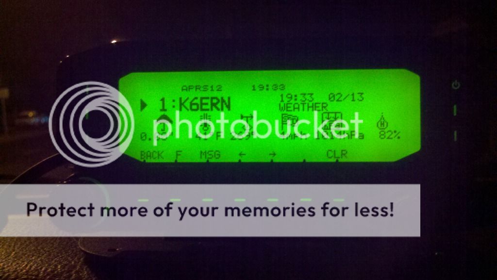

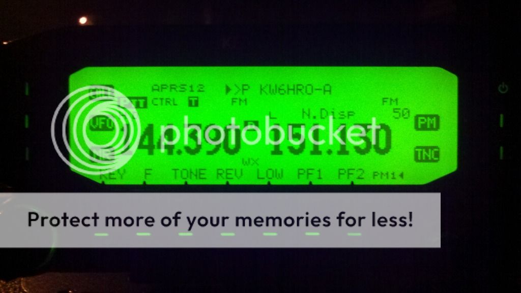

wow cool stuff all this popped up when i turned on TNC and did APRS12

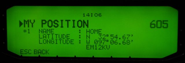

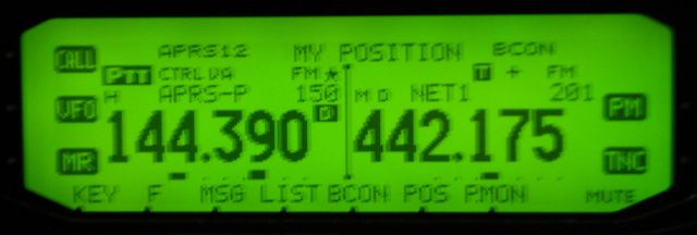

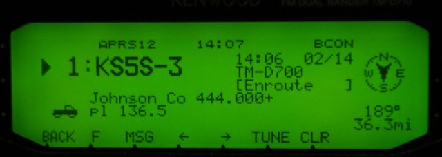

My display
My display looks a little different and not sure why. I didn't see bearing and distance information under the compass rose. The last pic with MY POSITION is an indication that my beacon was heard, retransmitted and that was heard by my radio.
GPS input was off and MY POSITION #1 was selected. With that I could beacon my position and receive other beacons and display bearing and distance information. Something I had not tried before.
Hope that gives you a little more information as to what you should see.
Mike
