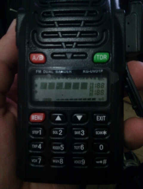

Hi, I have a problem with my station. Yesterday the gang try to open and I think there was an error during transmission to restarting stayed dead. You know how you can solve? because not even let me enter the menu.

I tried removing the battery for 10 hours and nothing. The master reset takes you inside the menu, but I can not because it will not start.
Know if there is any tool to flash it? or some way to revive it?
Greetings.
It happened when I tried to program the talkie. I was re-programming the software, I swichted off and when I turned on again the screen was as in the photo I posted before. Now, it is in the same situation.
I tried to conect with the PC and it does not conect. I suposse to activate it it will be necessary to reflash the unit. I have been surfing the net for some solutions and I find nothing.
The firmware cannot be "flashed" it is a "write once" chip. I had one where my display contrast went to nothing... you can see the display.. if you look at it at the right angle, under right light conditions.
I bought another. Mine does what your does sometimes.. but if I turn it off, then on again, it is okay.
Too bad the software has some "bugs" that seem to be permanent.
Dead radio fix that worked for me
Mine did the same thing and was a brick. I opened the programing program and went new with no freqs added. I plugged in the radio, turned it on (even though it was blank) and downloaded the blank program. Surprise the radio came back to life. Next I just started over and reprogrammed it with the freqs and settings I wanted.
You may want to try that before throwing it away.
