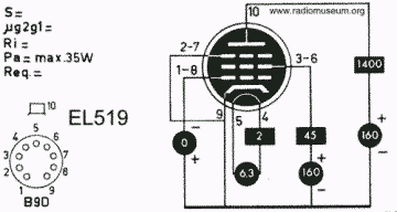

You might also find the pinout of the tube (EL519?) and use a ohmmeter and see a short that way. The heater element is the only short you should see, IIRC.

As far as testing the tubes without a tester, you can check the continuity of the filaments/heaters with an ohmmeter but that's about it. And for that you'll need to look up that particular tube and see which pins are supposed to have continuity and which not.
Reactions: 1 person
That pinout should help some . . . I recommend that you find a tube tester and see if they test OK.
