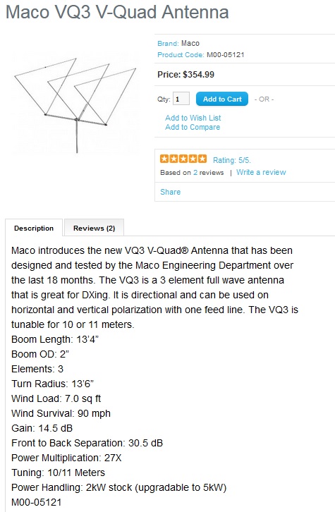

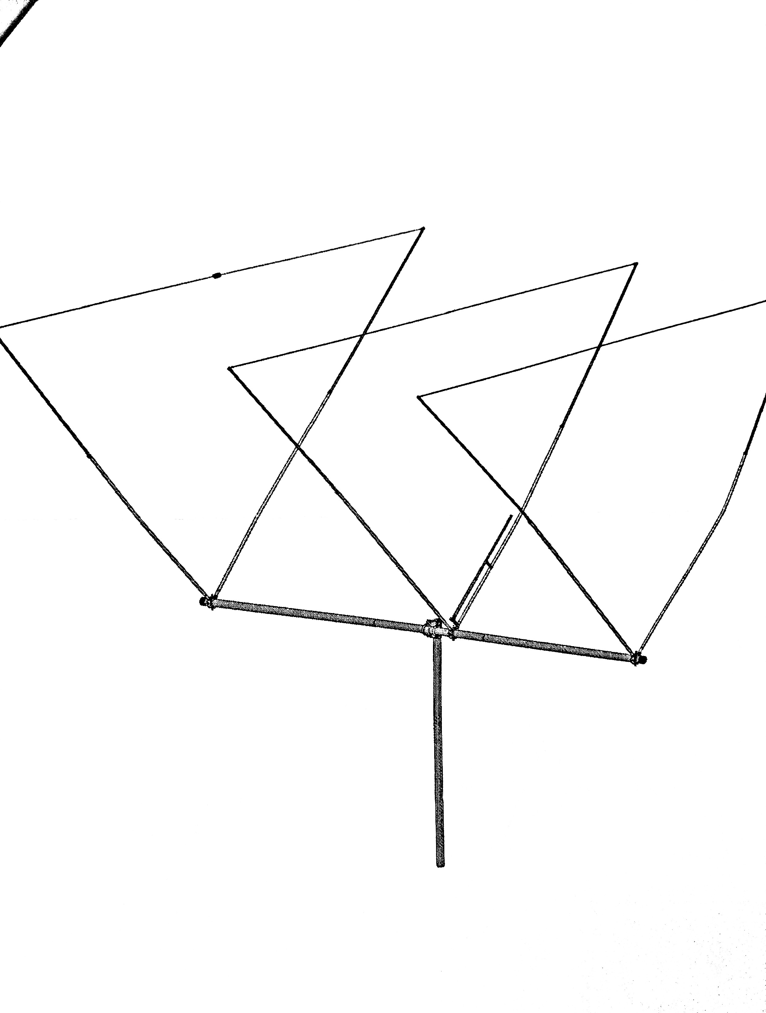

Does anyone have any experience with this antenna they can share with me. I am trying to decide between the Maco VQ3 V-Quad and the Maco M104C 4 element.

I'm afraid your figures on gain are incorrect. Add in the higher take off angle the VQ3 should outperform the M104 on long distance skip.

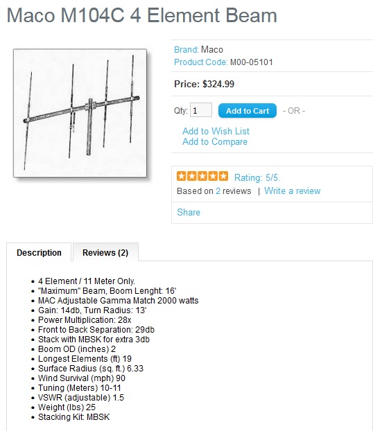

Correct, I was quoting what is on Copper Electronics. I did not understand how the VQ3 has 14.5 dB with 27xPM, and the M104 has 14 dB with 28xPM. Is this the takeoff angle you were talking about?
No, the takeoff angle references the radiation pattern and the angle at which I believe it hits the ionosphere and is bounced back toward earth (someone more technically minded here correct me if I am wrong) of which the angle of the VQUAD / VQ3 series has a superior angle for longer distance per bounce, or maybe it was shorter, whichever was better the VQ3 was ahead vs a four element I beleive was how it worked out. There's an excellent thread on the VQUAD vs 3 element in antenna simulator somewhere on this forum which would be similar to VQ3 vs M104.
