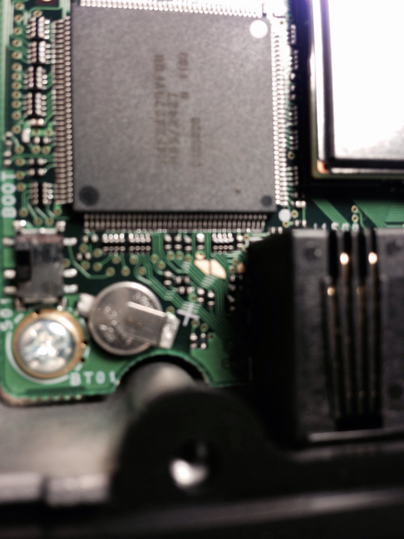

NEW MARS MOD
There is a procedure out of MODS.DK for Mars on the FTM-400DR. It appears to be someone out of Italy. When I looked at the picture of their FTM-400DR and compared it to my US version the resistor arrangement that is discussed appears to be reversed. It appears they are removing the right most resistor of the two. On my US version the right most position of the two resistors is vacant and the resistor is in the left most position (of the two). Maybe I'm not looking at it correctly, but I don't want to damage my radio. Anyone with an FTM400DR that can take a look at their radio and and compare and give me some input?
Thanks, Joel
Here is a pic of my radio. Not Very good since it's from my phone.
I just received confirmation from the Yahoo group that the resistor location is reversed from the US vs EU units and removal of the resistor on the left on the US units will brick the unit.
