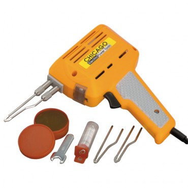

Ok I am pretty confident on soldering but again vocab(sorry) I have a solder gun from harbor freight my son bought.
and

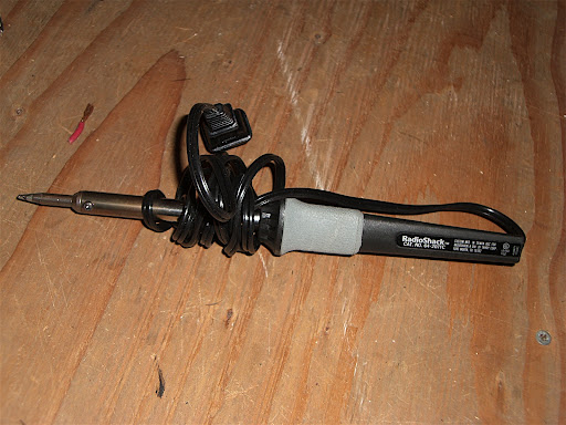

then the pencil tip iron from Radioshack (pulled off the internet not mine but close)
so which is the 35 watt iron?(sorry I feel silly asking.)

The Pencil iron is a 40 watt, it will work fine. The gun is probably 100 watt and is to big for a job like mic wires.

Neither of your irons are ideal for doing mic plugs, much better to use a 15 watt or 18 watt pencil iron on mic plugs, 25 watt maximum. far neater and less likely to cause shorts between the pins.
Solder guns are pretty naff for doing anything related to radios, pencil irons having smaller tips concentrate the heat where you need it most which is ideal.
