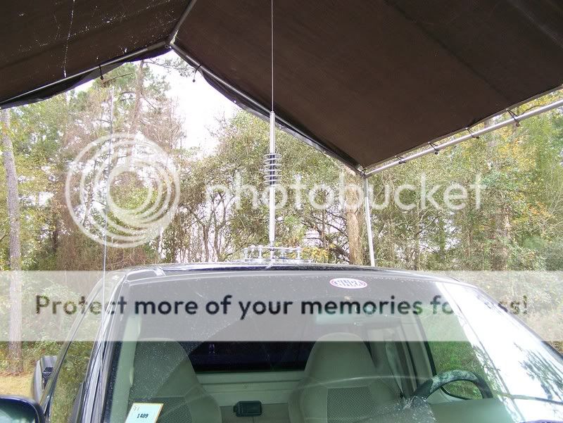

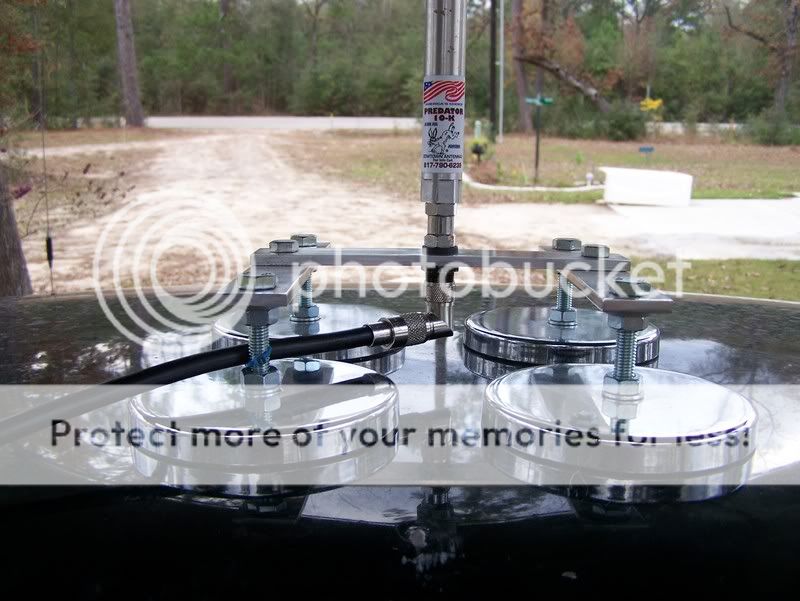

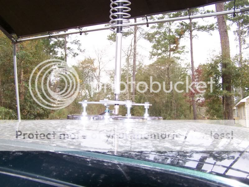

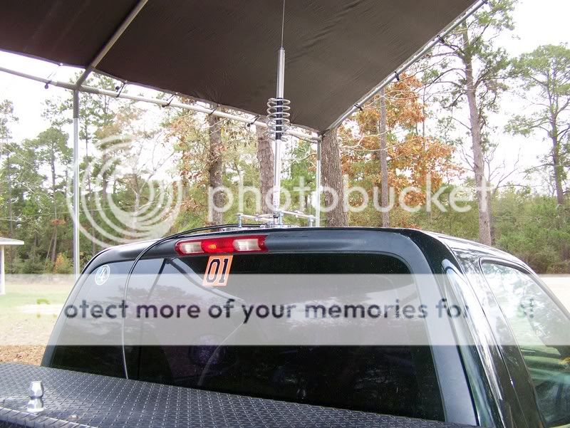

I ripped off my quad mag and 10k on a jack in the box drive thru a few weeks ago. I wanted to go ahead and upgrade the coax. I went with 18' of lmr400 and spaced the quad to allow the 90 degree connector. The antenna is a new 9" shaft single coil 10k. I have 200w forward power and the reflect doesnt even register on the palstar. I am happy with the results but I dont think I will be able to run it, its not practical for me but i wanted a project. Looks like for me I will have to run a 102" with a spring off the toolbox. Let me know if you are interested and I might let her go.
