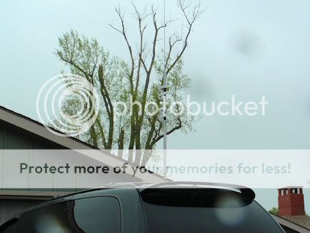

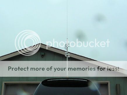

Here is what I run in a Grand Caravan and Crysler has a service Bulletin out that has a lot of usefull information on installing Mobile radios and Antennas and they say in it that a guy should to a hard install when it comes to mounting the Antenna and not to worry about the value going to shit when you drill a hole. I showed that to my other half and once she read that I was good to go and I'm glad I found that bulletin too.
I'm running a Mr.Coily Comp Antenna mounted about 12" from the seam on the back tail gate or the rear spoiler and I also used a Mr.Coily mount and used a Hank BreadLoves Brass Ball Quick Release Mount which makes it nice to have so you can drop that Antenna down in less than 30 seconds when you need to or get in the Garage with it.
For radio right now I'm running a Galaxy 99V with a Old School Messenger M1200 Amplifier and that set up really works nice with that van.
