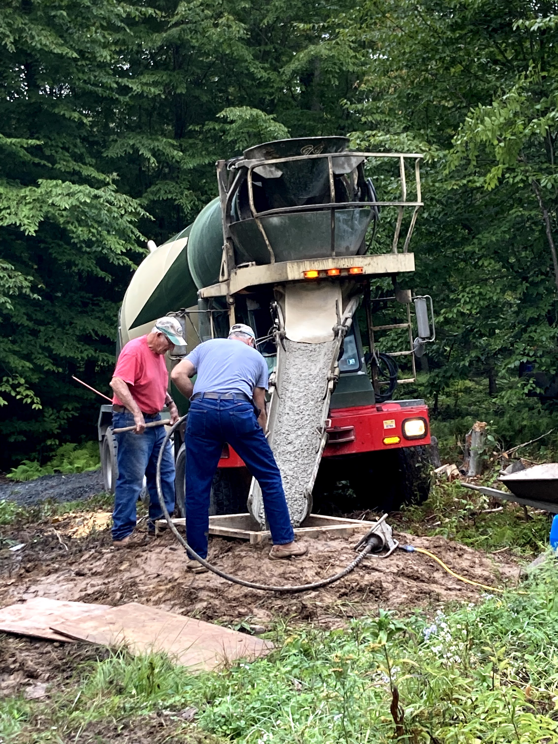

Concrete poured for base of tower #2 today. It has been raining so much this summer in eastern Pennsylvania it was difficult to schedule the contractor.
Also, not much top soil here. Go down about 3 feet and hit the rock ledge. Contractor has to drill into the mountain and cement in the rebar cage in the rock. Same goes for the guy anchors. Quit a chore and not cheap.

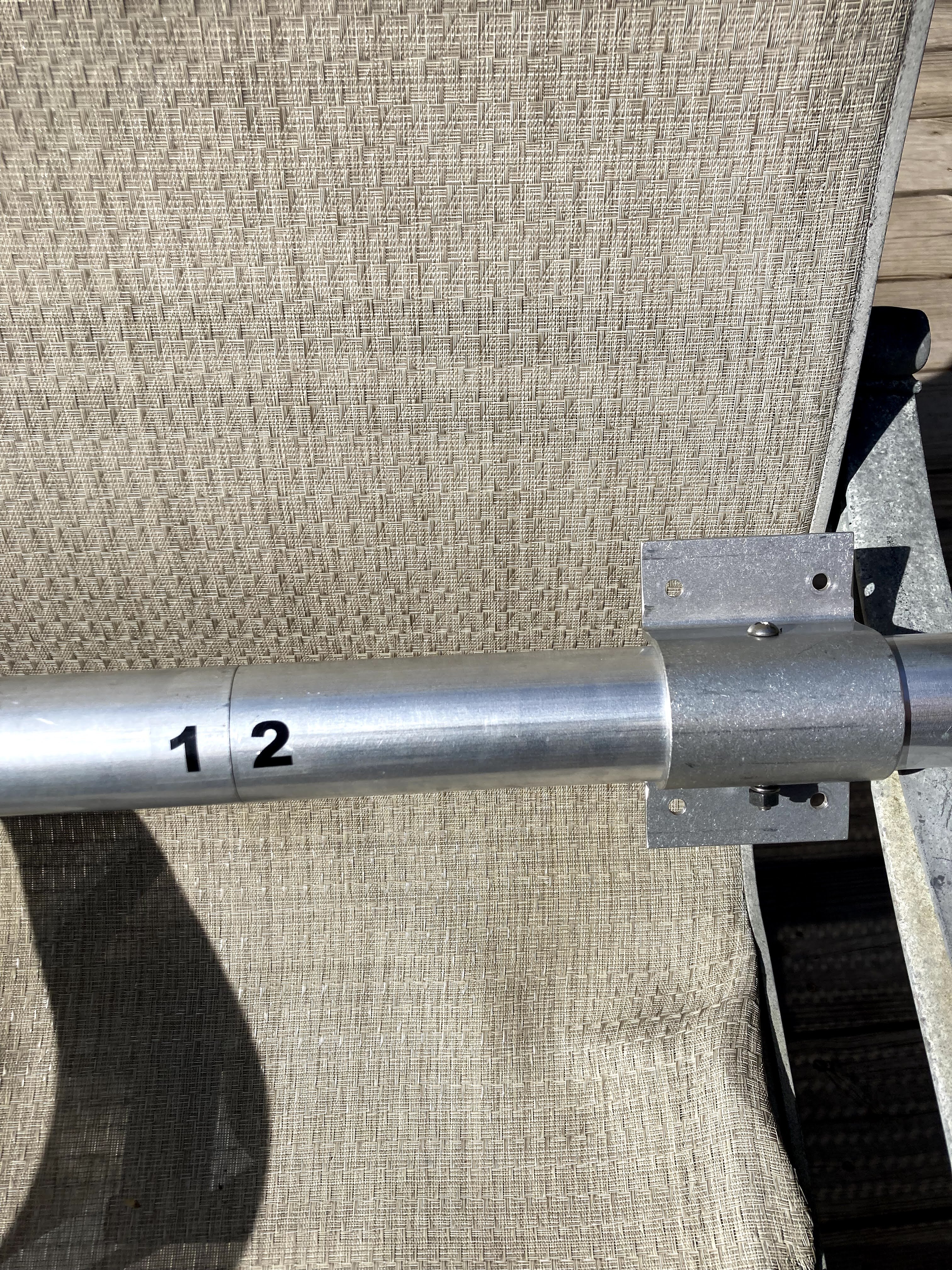

Antenna is a DX Engineering Skyhawk (3 el on 20, 3 el on 15, and 4 el on 10). The elements are assembled. Just have to mount them to the boom.

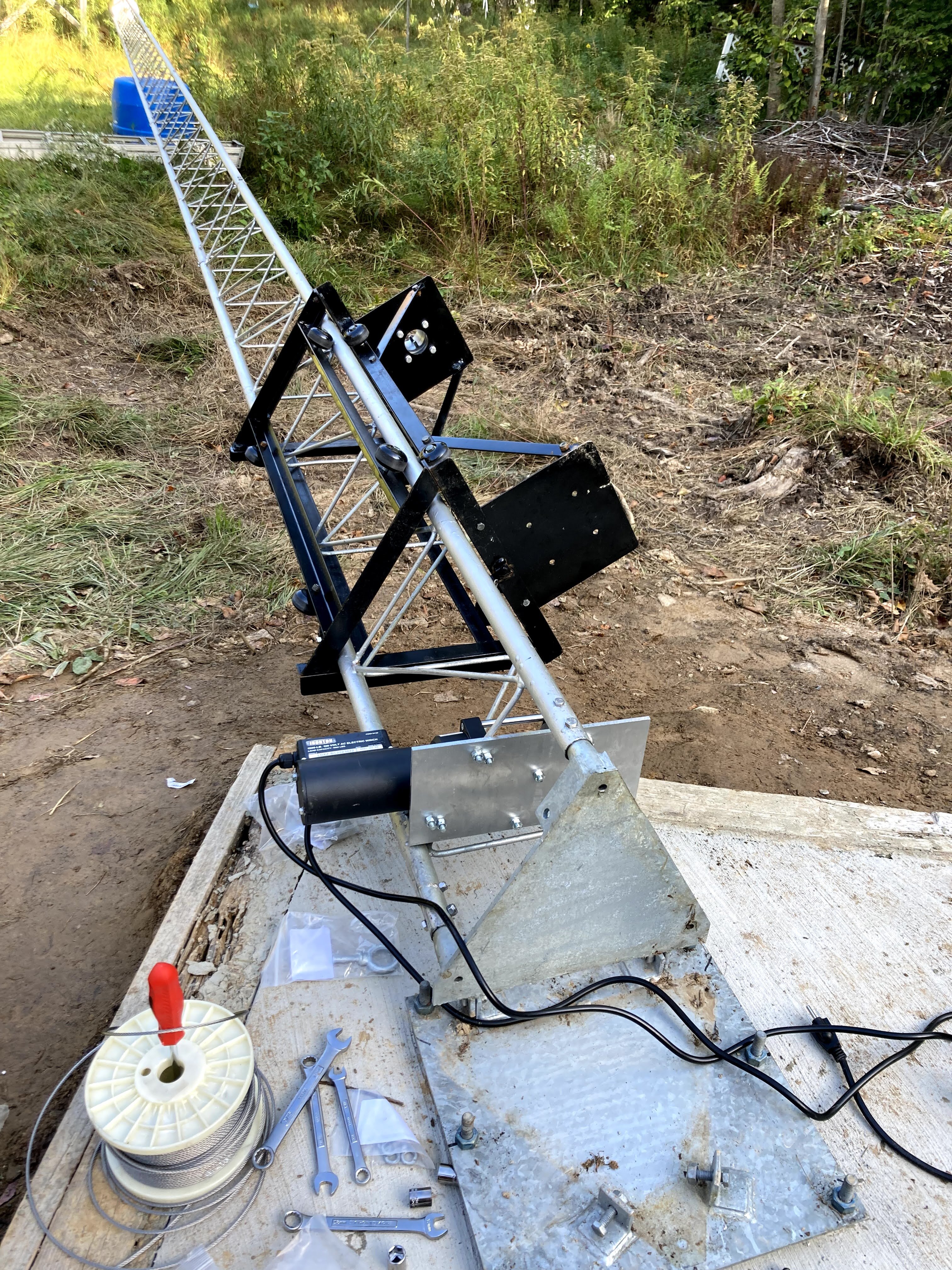

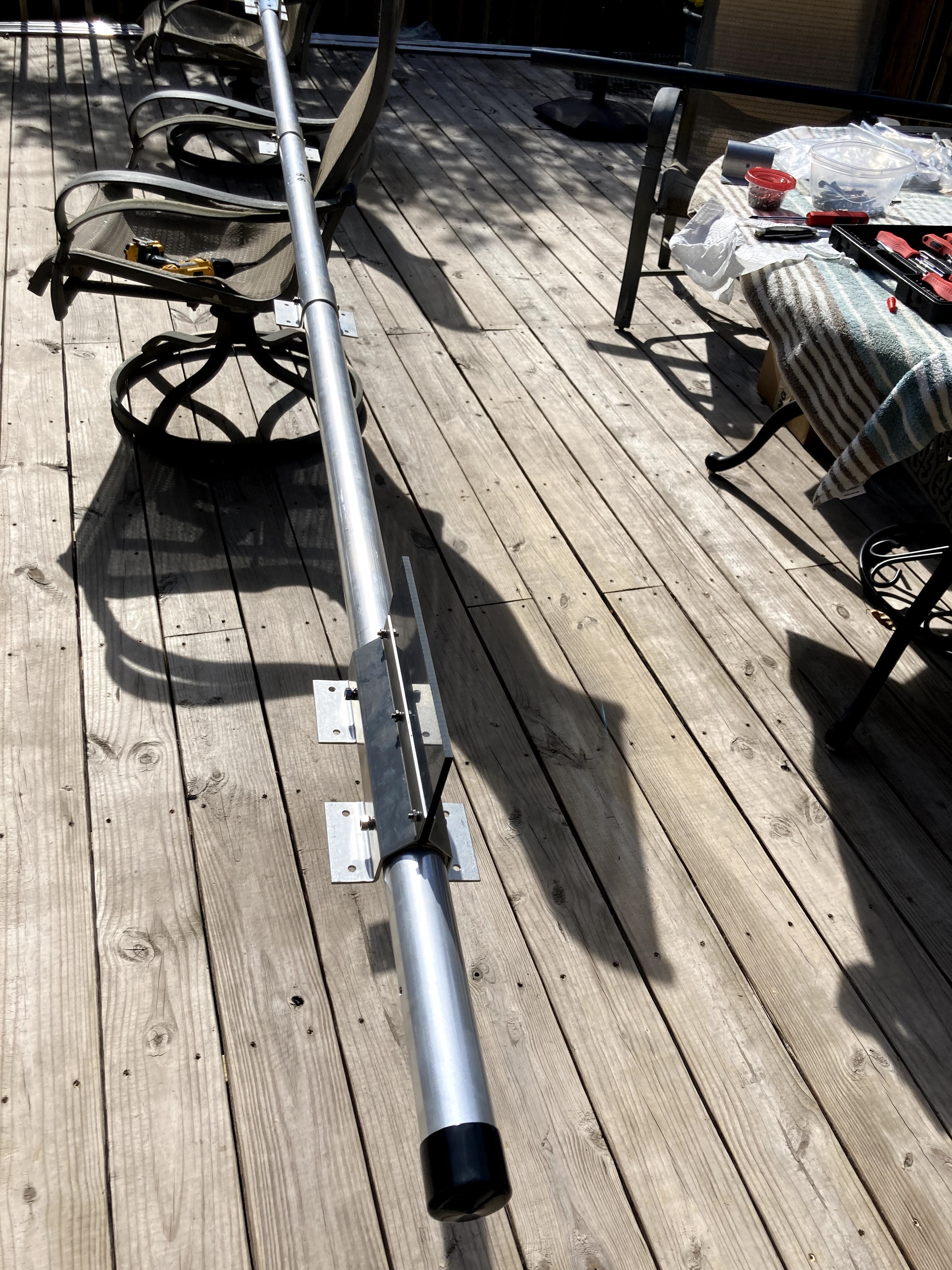

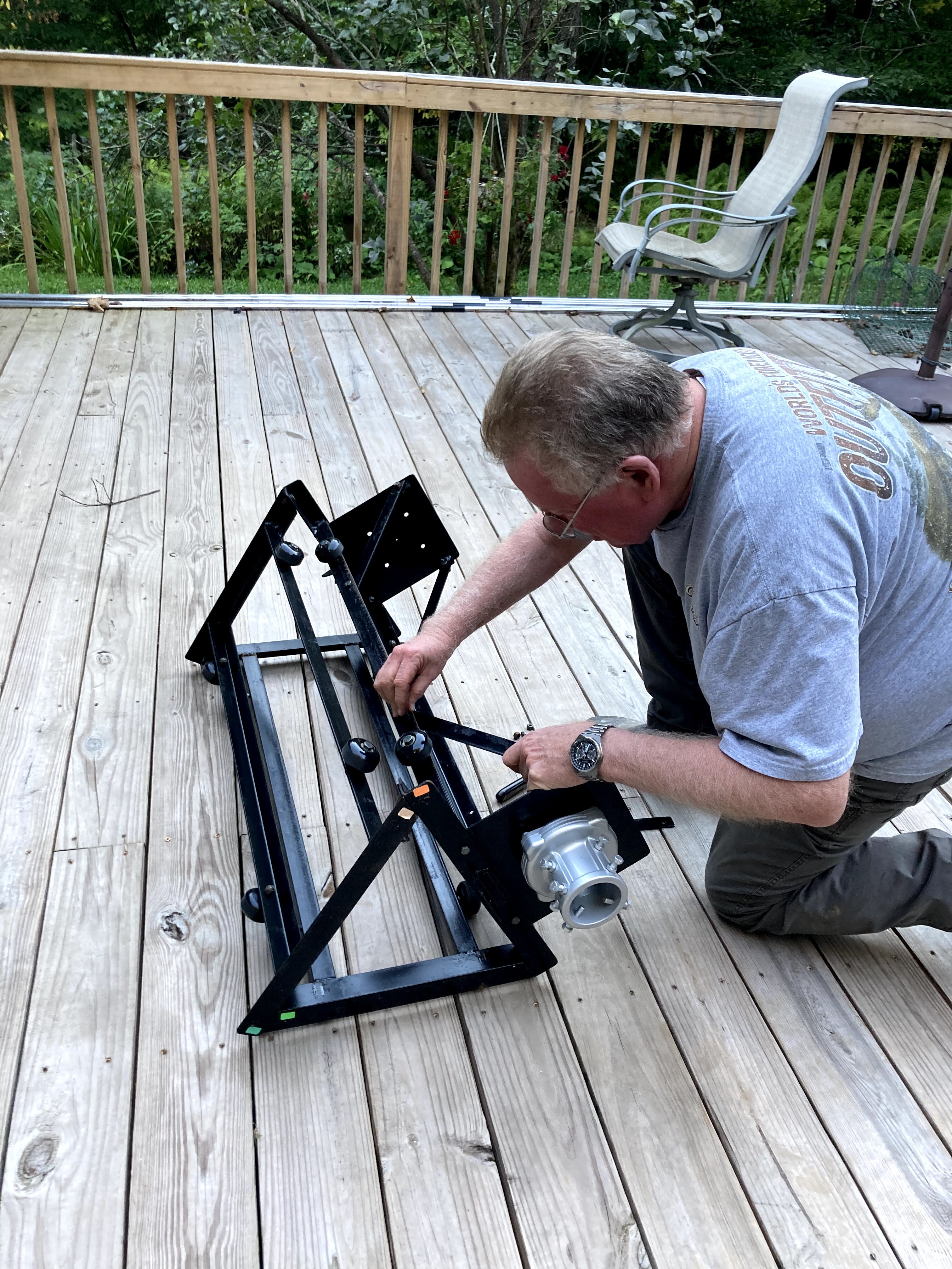

A couple more pics for Tower #2. The rebar cage, the tilt plate, and the hazer.
We decided to try a hazer to make it easier to service or add another antenna.
Going up today to assemble the tower and install the hazer. Oh....it is a 2 hour drive from my house to the ham shack.

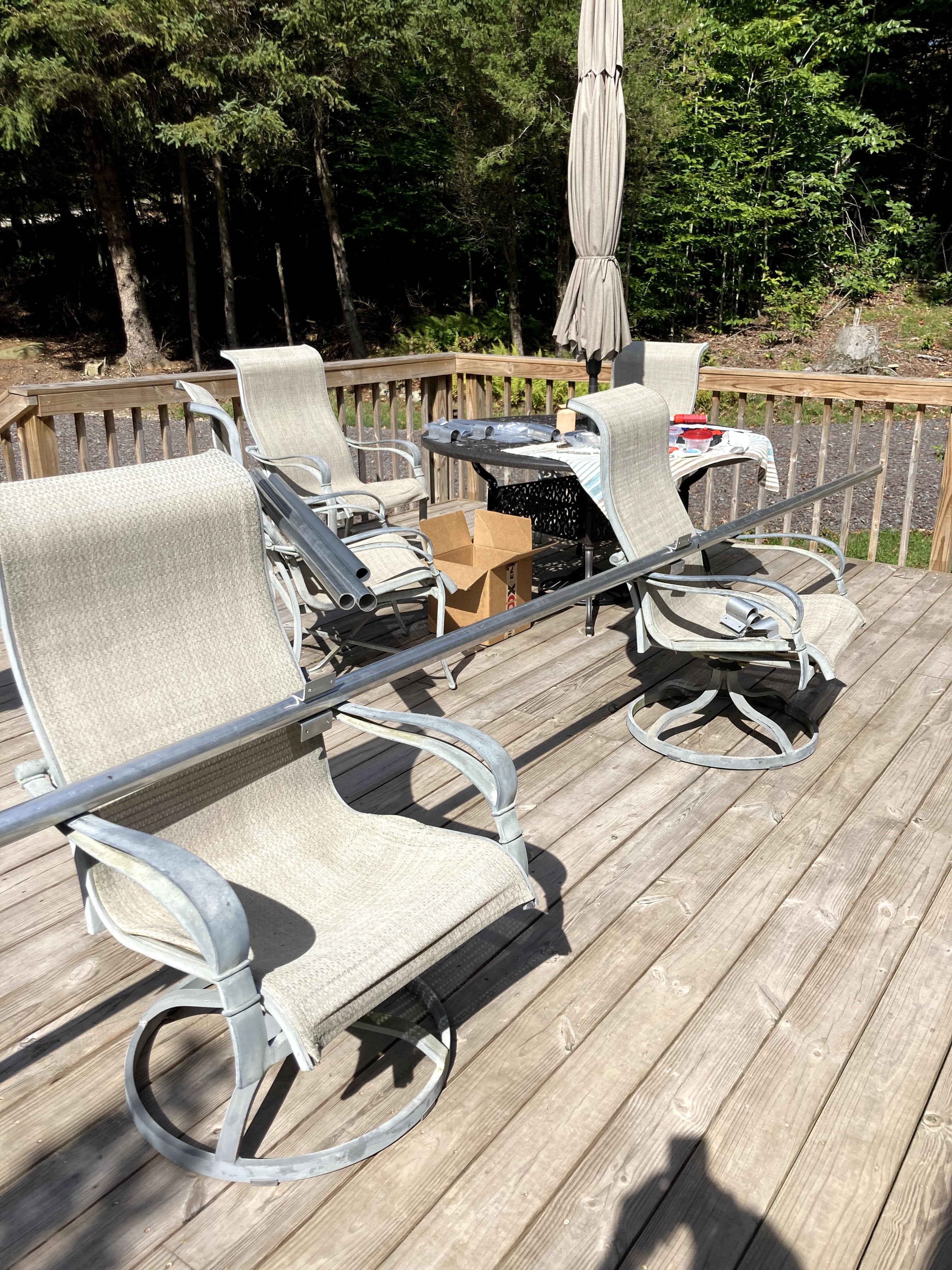

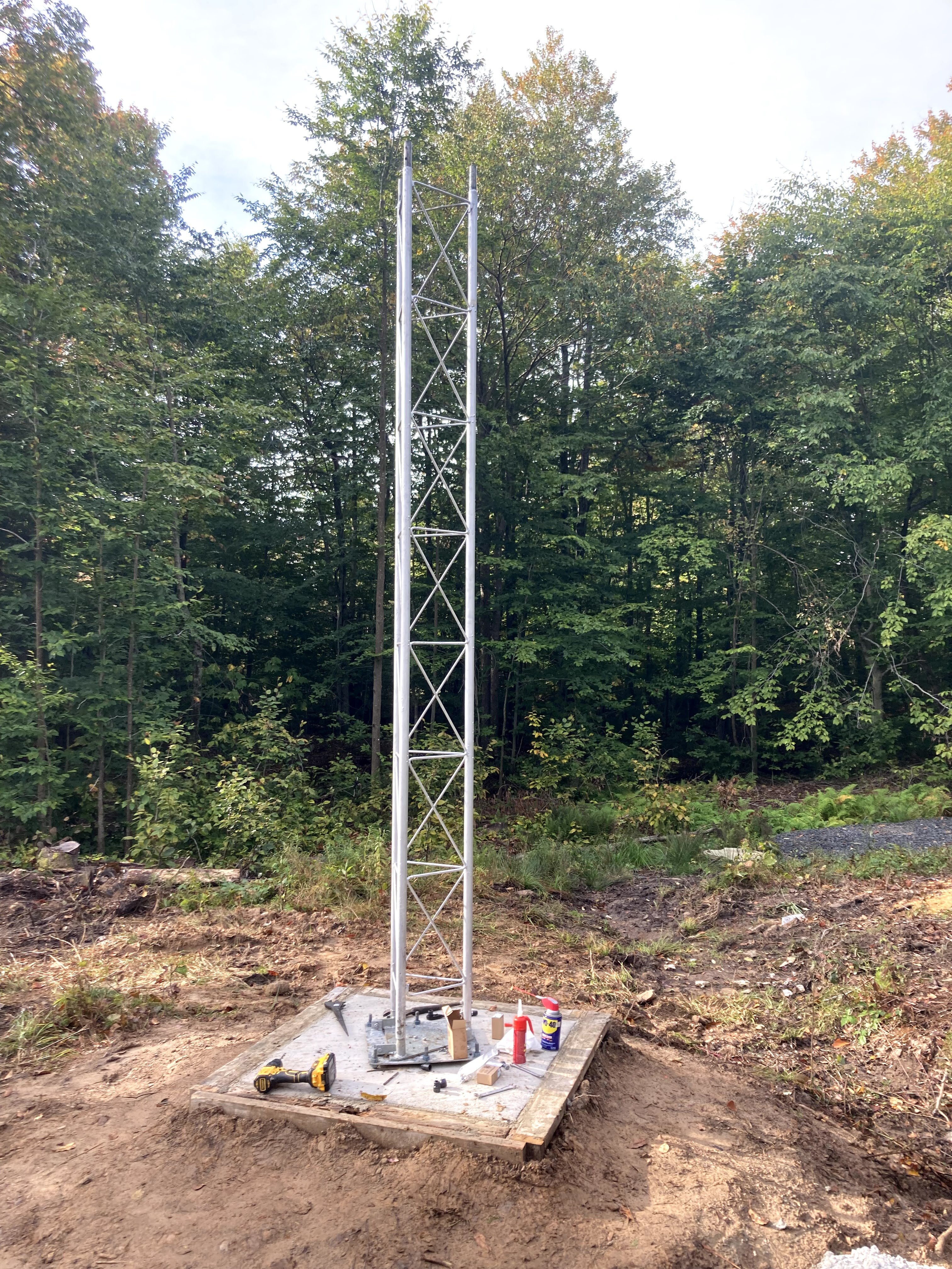

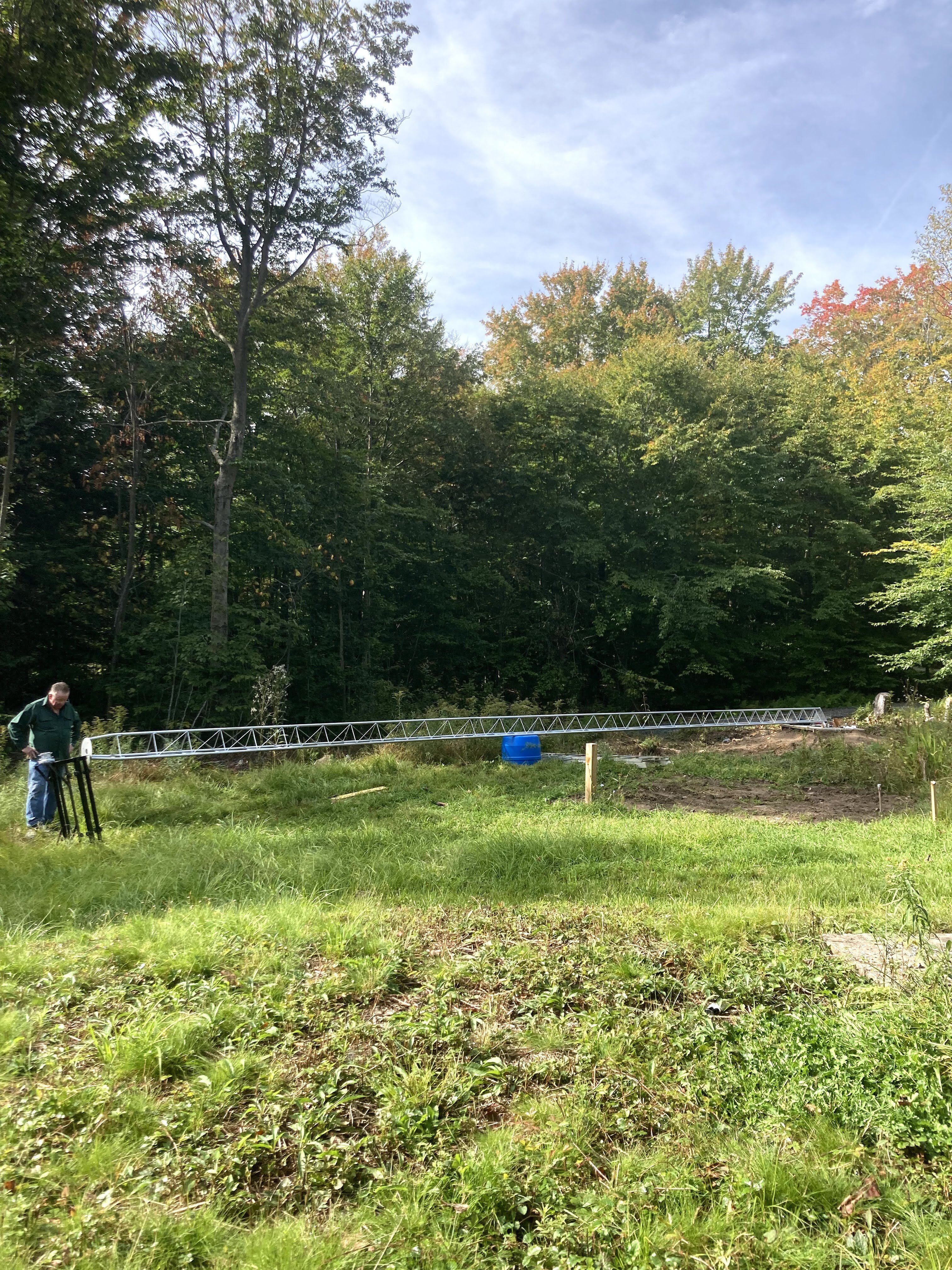

Saturday was a beautiful day and we were able to get a lot done. Tower is assembled and mounted on the tilt base. The hazer and it's winch installed and the boom for the new antenna was completed.
Sunday's chores will be to set up the guy lines and mount the antenna elements to the boom.
