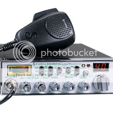

Does anyone know how to get the nightwatch feature on the Cobra 29 nw wx radios to work. the new one I keep reading says that you get the illuminate panels.
I bought mine used on E-bay. What do I have to move or replace in order to get the thing working again? :?: :?: :?:
P.S. whats the button to turn it on? :?: :?: :?:

Yes of course I'm referring to the green lettering in the faceplate. :roll: I moved the dimmer switch up/down and had the meter & the Channel display change, But the green letters never turn on; let alone get brighter. That's my problem; How do I fix that. Could it be an inverter problem Like I read in another post or could it be something more simpler. :?:

Q. The dimmer works properly in adjusting the lighting of the channel display and signal meter. But the front panel does not light up. Is this a simple fix such as a bulb replacement?
A. The "nightwatch" lighting uses an EL or electroluminescent material that does degrade with age. If the radio is old, then it may be lighting very dimly (check in a dark room with the dimmer at full bright). The material is connected by a ribbon to a special high voltage pulsed power supply that runs at about 500 volt. If the power supply is working then a new face would be in order or a new radio. If the power supply is not working it may be repairable but requires working with surface mount components. Either way, it is NOT a simple light bulb fix. I have successfully repaired and do stock the smc components to repair but cannot get the faces through cobra ($$$).
