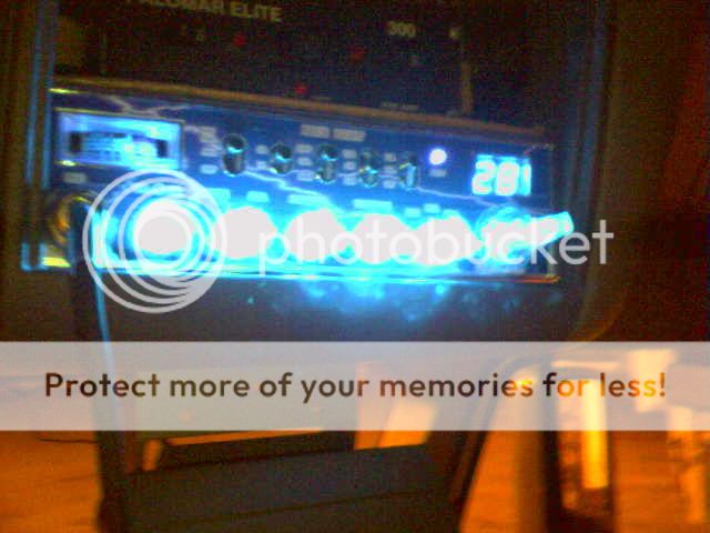

OK, the Nitro Knobs are installed by a guy I know who fixes radio.
The only problem is that the lights in the knobs are really bright:
is their a way I could dimm them a bit buy adding a resistor in line.
