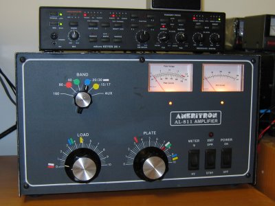

some people even color code them for each band,.......... YMMV
[QUOTDainBramage, post: 518609, member: 42889"]some people even color code them for each band,.......... YMMV
[/QUOTE]Only
one color needed here. That may eventually change but no ticket limits me to 11 meters. I've seen mamy amps on eeBay with those and other marking mmaterial. I've even seen anps with magic marker to locate proper tunning points for different bands. Probably not a good idea to permanently mark up the face of ones amp. It definitely makes more sense marking when you have several bands to operate on. Thanks for the picture.
