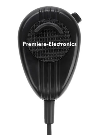

The link in the first post takes you right to a giant picture of it. It's slightly smaller in the outside dimension than the 636L but it's pretty deep, so it's a decent handful of a mic.

I thought I would post a pic of it, so that readers would know what we were discussing here.
There are a few companies that imitate the original Turner RoadKing 56 mic. This mic is also a knock-off of the original. Priced at ~$20; seems to be a bargain for a noise-canceling mic. So long as the audio quality is comparable to the original Turner RK-56; I would like to try one too.
