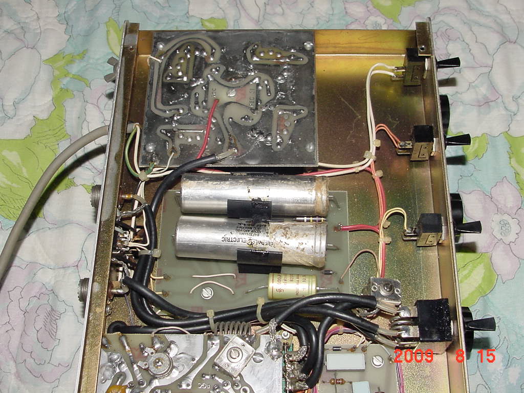

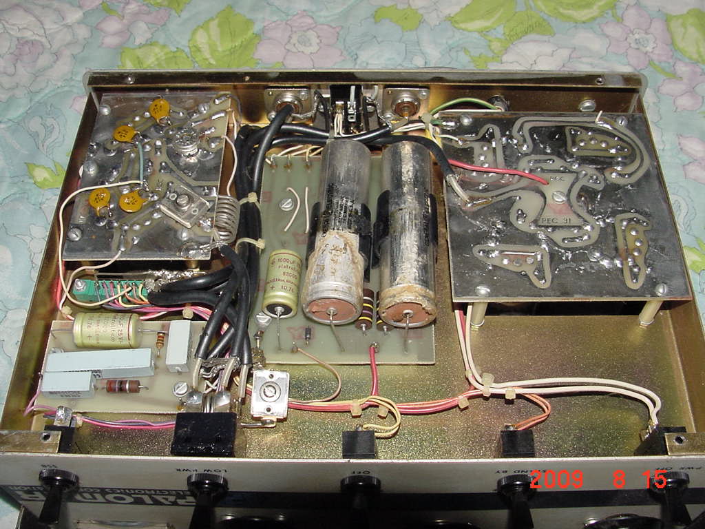

I have the amp on the bench and checking the schematic I do not see the rectifier stack on the board with the big caps. any idea where they are? Am sending a few pic of the amp.

Found the rectifiers all tucked under the big caps. Getting things ready to send an order to start work on the amp. If I can find all the parts to rebuild it. Have been practicing on my soldering and wish I had a little better steady hand but all that goes with age so will make the best of it. Also found a better pic of the bottom of the amp.
