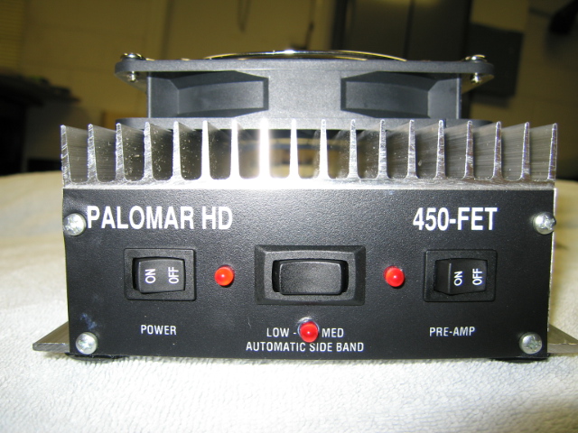

They get hot but!!
A lot of good information at the sparky link thank you TonyV
it looks like they get full output around the 110 watt range. I'm still interested in if they tend to get hot quickly.

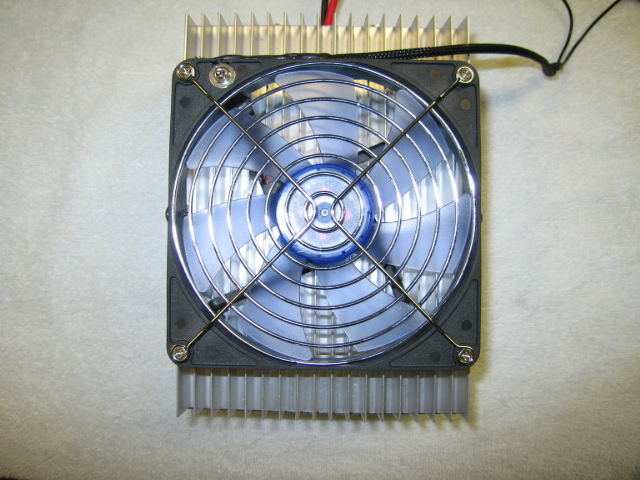

They do get hot but its nothing a good 12V fan wont fix in your car or truck. I have a home built MofFet amp based off the FET 450HD that does right at 1100w and its a base plus I run a 450 FET HD in my truck. They do great for the money but need to be kept cook. I used mini fans on my FET 450 in my truck, drilled holes in the heat sink and use the fans to pull the air threw the heat sinks. I have a digital thermomitor that I can read on my dash as well. I am a Ham and CB lover plus a tech to boot but all these mods can be done by the average radio guy and a simple 12V fan will work great. The thing to remember is to not have to much key down time! 10to15 seconds is good. 20 to 30 seconds , not so good! Good part about extended key down is that the mosfets can be replace by a novice radio guy for less than $15.00!! I also run a DX94HP with my 450 FET HD!
