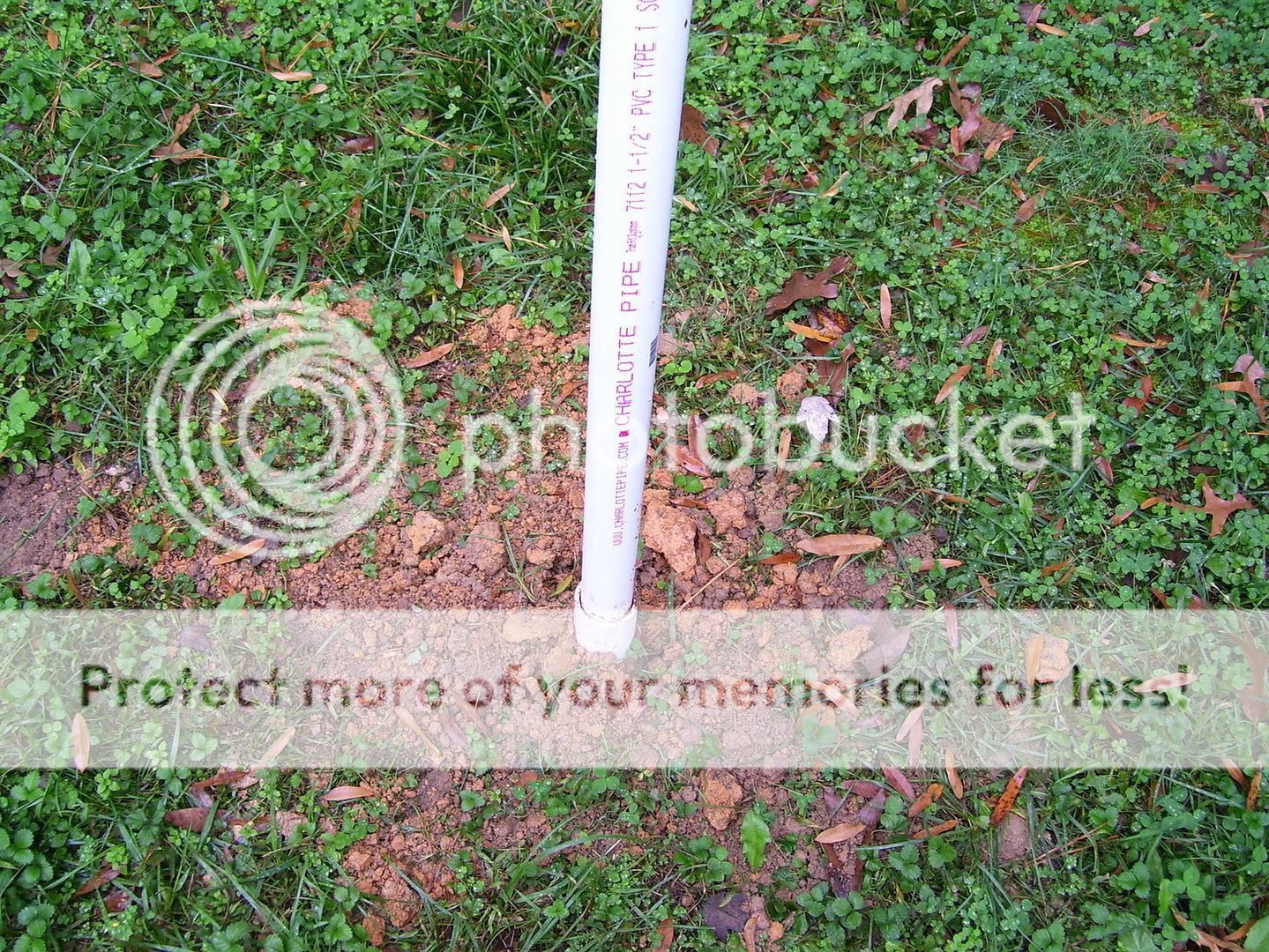

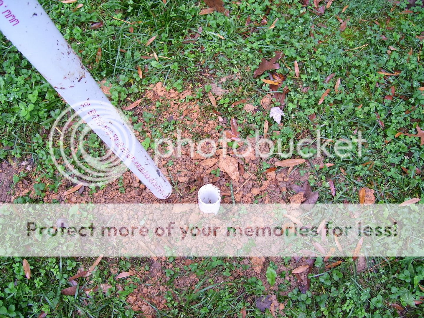

when i was initially working on my 5/8 home-brew i dug a hole about 22 inches deep and put a 2 ft piece of 1 3/4 or 2 inch (i forget which) pvc pipe in it and stuck my 10 ft 1 1/2 inch piece in it and used the level to pack the dirt around the 2 ft piece and keep it vertical . concrete and metal conduit would be much more sturdy and durable though , i just needed something temporary .
anyhow , thought id mention it as another option .
