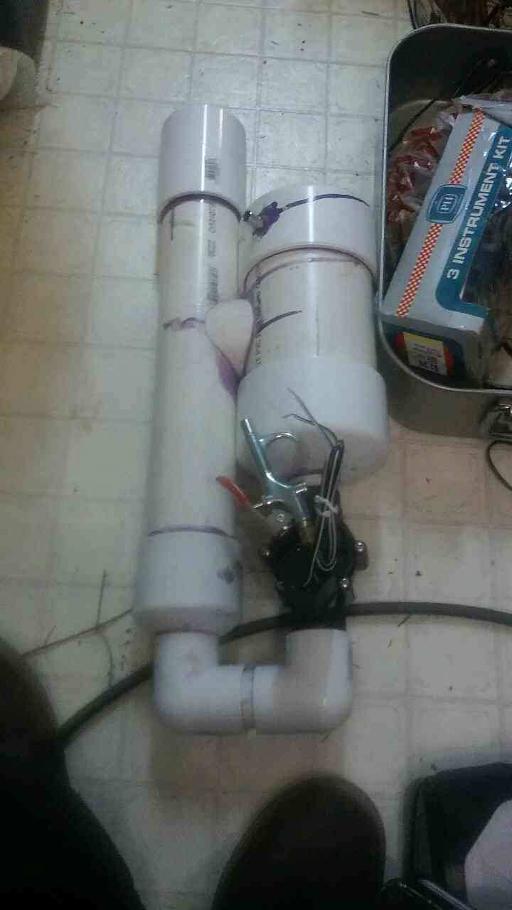

Or , how to attempt a weapon of mass destruction with PVC pipe, an irrigation valve and a surplus of tennis balls.
I've been building these . First high pressure test was an unweighted ball, straight up. I lost it in the clouds. Estimate it was 350' up.
Weighted 4oz tennis ball trailing construction line was at least 150'. The issue is a balance between enough weight to pull the line down the far side and height of launch. 4 to 6 ounce is the sweet spot. I need to look into options for a bit less line friction as in braided Dacron fishing line , Monofiliment , etc.
On a safety note, 6 Oz produces significant recoil. Do not load when pressurized , can you imagine a discharge when you were standing over it ramming a ball home? Do not use when freezing as the PVC is brittle. Don't point it at anything you don't intend to hurt, injure or maim, do the math, if it doesn't kill something or someone it will hurt. Just treat it as a weapon.
I have some advantages for construction. A lathe makes for precision press fits of the tubing as well as a bit of flaring on the inside of the reservoir for extra strength. I have several small compressors that work well up to 100 PSI @ 120 VAC. The 12V compressors not so much.
