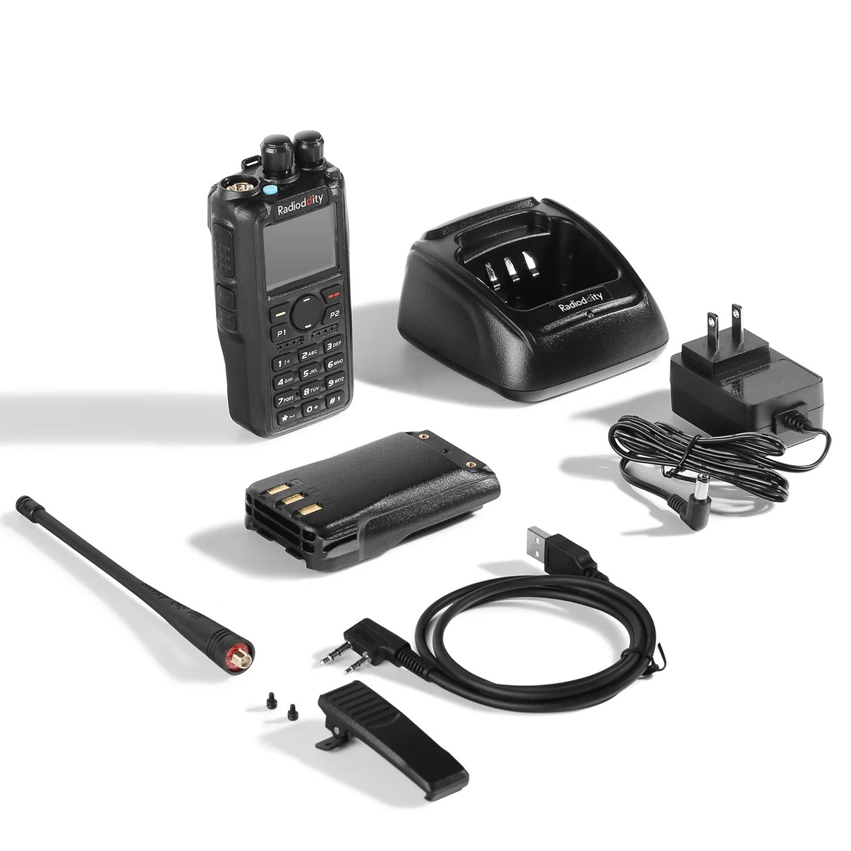

My radio came with a battery, drop in charger with power supply, USB programming cable, belt clip (you mount it to the battery), rubber duck antenna, and a wrist strap (not shown in the photo).

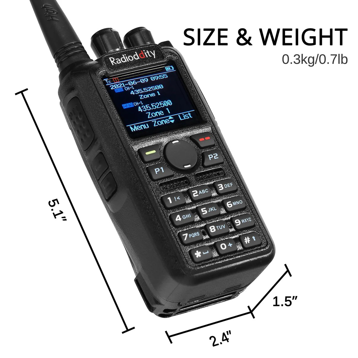

My first impression is that this radio is “substantial”. It is a little heavy in the hand at nearly 10 ounces (with the battery) but similar to my other HTs. The quality is similar to Yaesu, Icom, and Kenwood HTs I have owned over the years. Doesn’t “feel” cheap like the some of the Baofengs and TID radios I have owned.

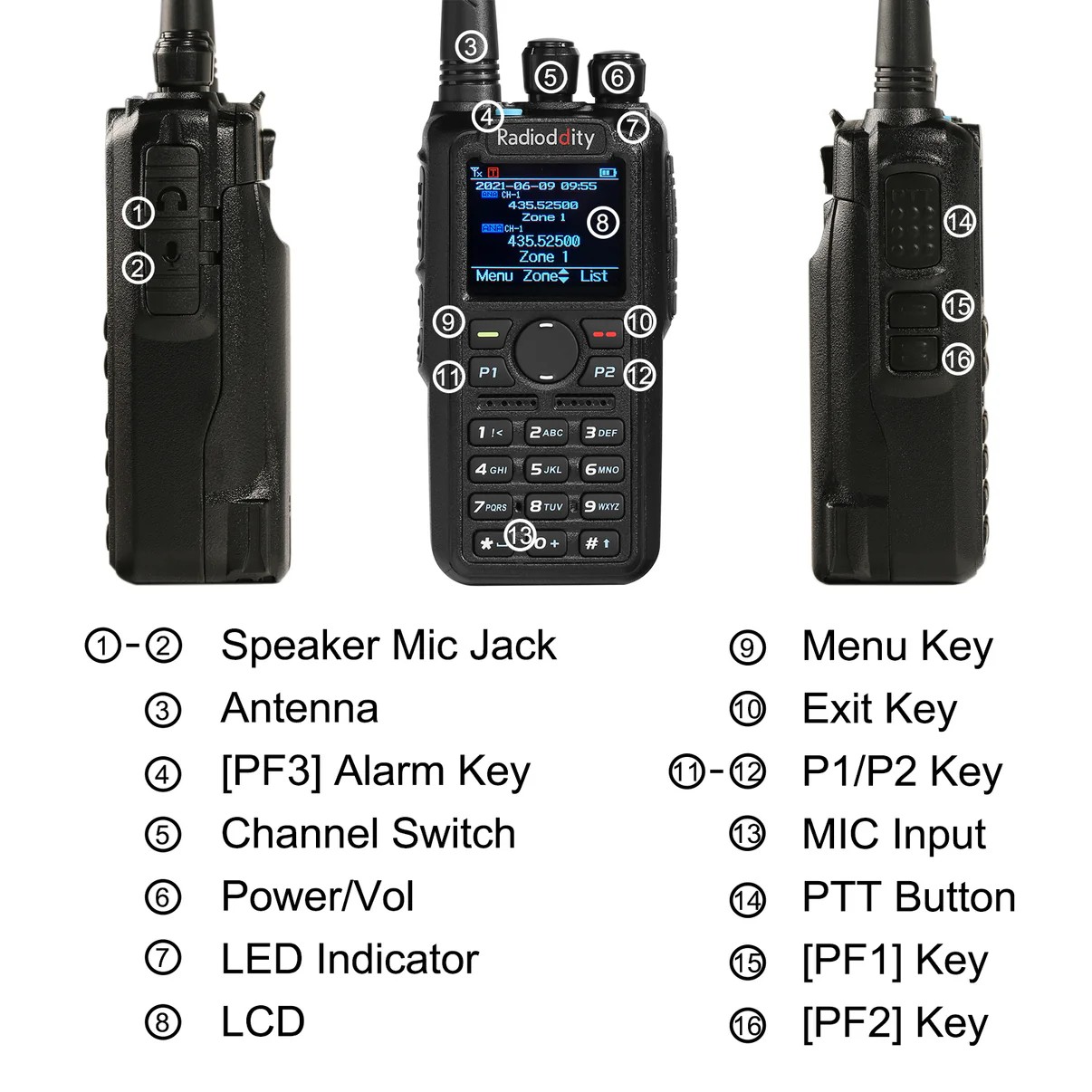

I like that the ON/OFF and volume share a knob, and the VFO/Memory selection is a knob. I prefer knobs rather than buttons for these functions. I find that I’m changing the volume often and I can do that while it is on my belt or clipped to a pocket. The keypad allows you to do everything without fussing with multi function buttons.
The radio has two VFOs so you can display and monitor two frequencies or memory channels. The audio is loud (1w at 16 ohms) and the screen is bright. It is easy to see the screen outside and hear in loud environment. The website indicates that a Baofeng speaker mic will work and I was able to use the speaker mic from my TID TD-H3 radio.

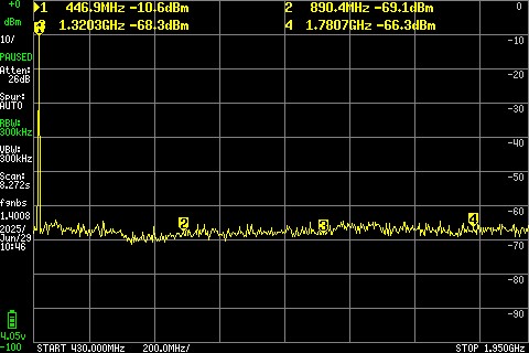

I was curious to know if the GD-AT10G complied with the FCC specs for harmonic attenuation. All VHF and UHF radios outputting less then 50 watts require that the harmonics must be down greater then 40 db. I used a NanoVNA to sample a 10w signal. Below is a screen shot of the test.
The 1st harmonic is 890MHz and is in the noise floor. To calculate the dBm harmonic attenuation you find the delta between the fundamental frequency and the harmonic frequency you are comparing, This test shows that the GD-AT10G is more than 55 db down from the fundamental frequency. This is a clean radio. I have thrown away a Baofeng and a Baofeng Clone that have failed this test.

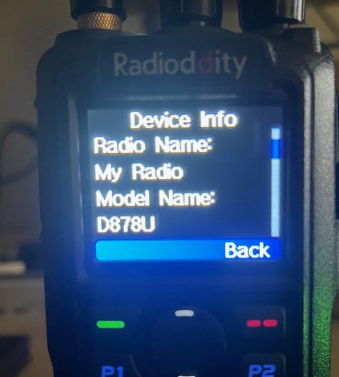

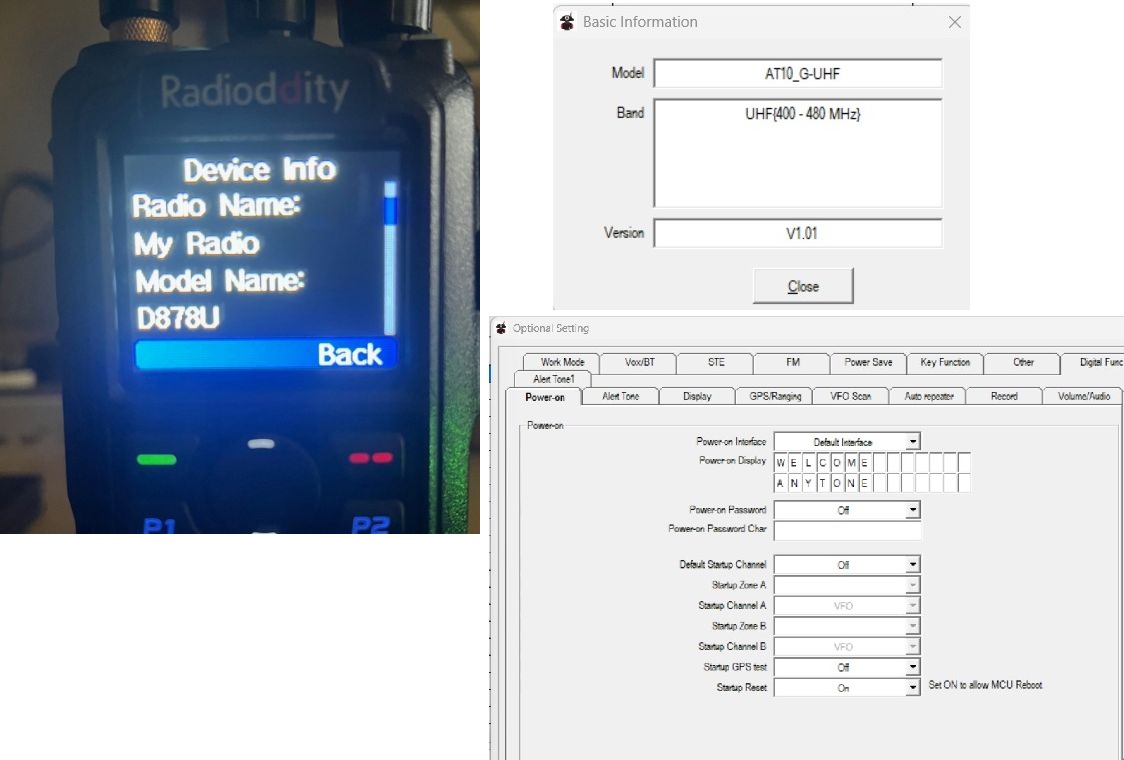

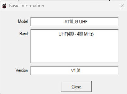

When you select “Device Info” menu in the radio it displays the Model Name: D878U. However when you query the radio from the software it shows the Model number as AT10_G-UHF. A google search for D878U returned several sites suggesting the AnyTone AT-D878U matched this Model Name. The GD-AT10G appears to be a re-branded Anytone Radio and modified for use on UHF only. Also, the programming software shows default Power on Display as “WELCOME ANYTONE”.
