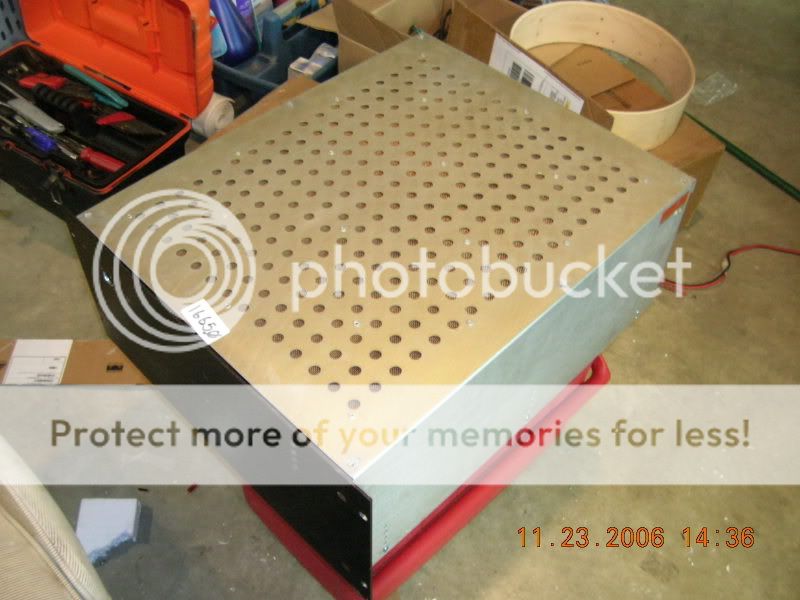

He started with a empty case and a idea

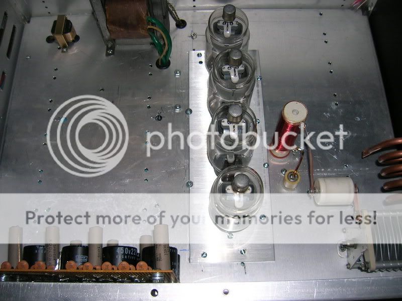

Next, he rounded up the parts, four 572b Tubes, High Voltage transformer, filament transformer, rectifiers, filter caps, plate choke, tube sockets, coils and other assorted parts.
Tubes mounted, DC blocking Cap (Doorknob) and tuning Variable visible in lower right corner, isolation transformer for relay control and tube bias in upper left corner.

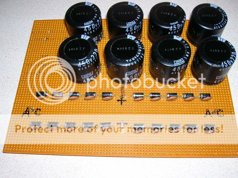

a 4x572b amp is my ultimate project amp, and with a bunch of these detailed pics, and a parts list, i know i can do it.

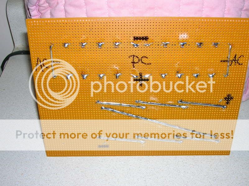

also, need more pics of the rectifier board.
both sides please.

This is before he put the .01 uf bypass caps on each diode; he stood the 30K ohm next to the caps, each capacitor has a 30k resistor in parallel with it.
The resistors act as bleeders when powered off and they balance the voltage across the caps when the supply is running.

Paw's I'm gonna have to get you some updated pictures. hell, I have the panel meters set, varibles in place "need to dip the coil" Filament transformer wired in as well as the choke, isolation transformer for bias is in place, tubes are now mounted vertically, Rectifier/filter board mounted. We need to get together and wire up/fire up this thing up soon. Really not much left to do.
