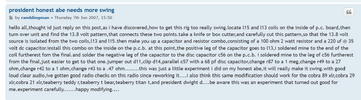

I have a 21 XLR I was wanting to try out the swing mod, but I am struggling to make sense of the instructions that I found on an old forum post. This is it:

I don't have my 29 XLR radios here with me, but figured the 21 XLR can also be done. As far as cutting the trace, Is this the place to do it? I attached the picture with the red line on if the cut needs to happen there..
The way on how to put in the capacitor also doesnt seem clear. Also, the clipping of d14 and jumping d11 seems like that is defeating the AMC limiter? If so, I do not wish to do that as I don't want to be splattering.
