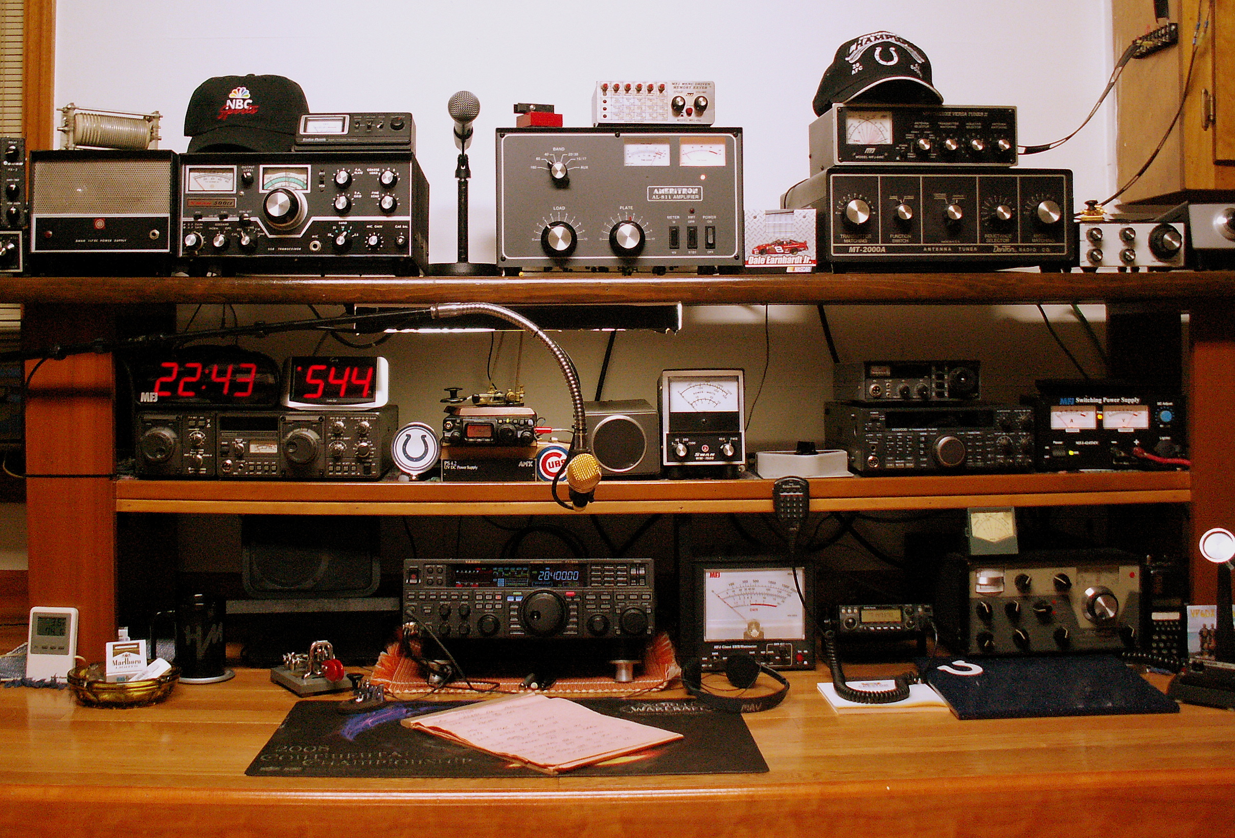

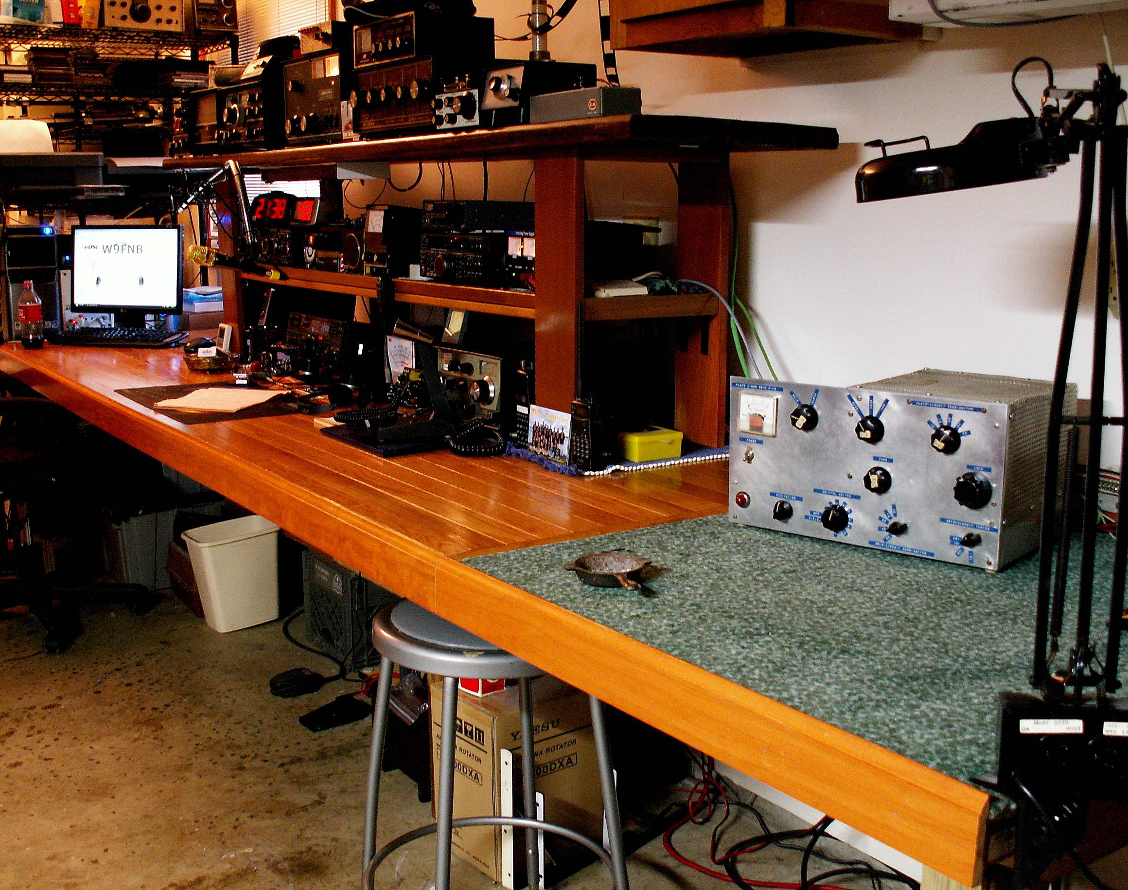

So that's what this plywood would look like if I took the time to put a finish on it ;-)
Nice setup.
74IN: Yes you called it correct. The bench is slightly over 13 ft long of 3/4 inch plywood. Then 10 ft of it is covered in 2-1/4" wide tongue and groove solid oak planks about 1 inch thick and sealed with acrylic (I'll never use that stuff again!)To much work!
The whole bench is built on 2 x 4 stud box frame and sits on 4 x 4 posts.
I can walk on it...no need to worry about overloading.:thumbup:
