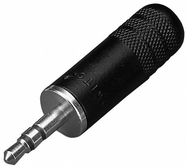

Continuous "dits" or "dahs"? Maybe the keying line input jack is shorted (bent leaf). Plug an unwired stereo phone plug into the key jack. If it stops, that's it.

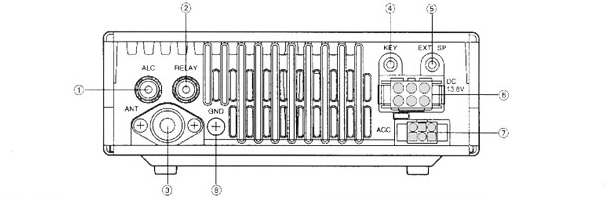

Try what VA3ES posted, plug in a 3.5 mm stereo plug to the CW key input (see picture, tagged #4).
Be sure it is just a plug that has no wires to it.
while it is plugged in, see if the beeping continues

Reading did me good, but did not fix the problem :sad: but what VA3S wrote whas the couse to the issue,thanks for that and hope your headbanging didnt hurt you ;)...problem solved.
