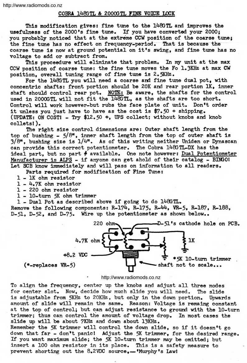

Here, I took this from the Defpom page.

Unlocking the clarifier
This mod came from a forum I am a moderator on:
This is what I have:
1 Cut R44
2 Cut D52
3 Solder a jumper wire across R 174 (or remove it and put a jumper in its place)
4 Remove red wire that comes from the Fine tune pot from the board and hook it to the + side of C84
5 Change R175 to a 1KOhm
Jeff
Dual Clarifier Mod
This is the dual clarifier mod, I do not know who originaly wrote this, as it was posted on my forum.
