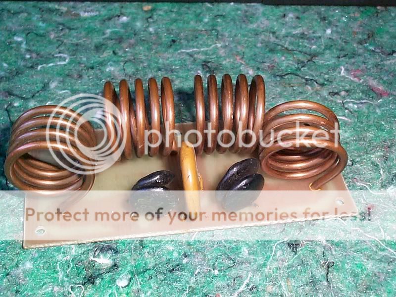

Now, to answer your original question: Brewer Labs, the builder of the Varmit series incorperated a low-pass filter in their design, it looks like this:
This filter may or may not still be in your set, pop the hood and take a look but, that filter will not help you against a bad signal in.
