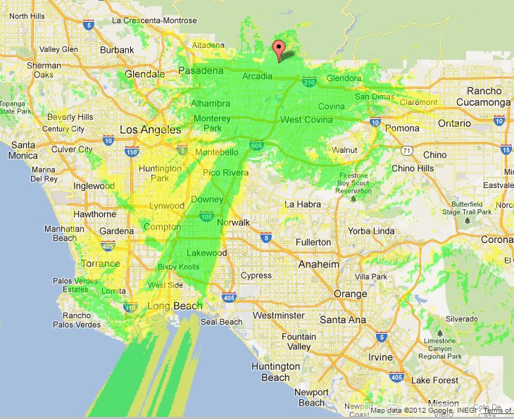

Hello gentlemen, I'm curious if this dstar repeater is still up and functional. I can't find any information on it anywhere and would like to use it if it's still up and open. I live in Monrovia, which should be very close to where this repeater is located (per the map).
