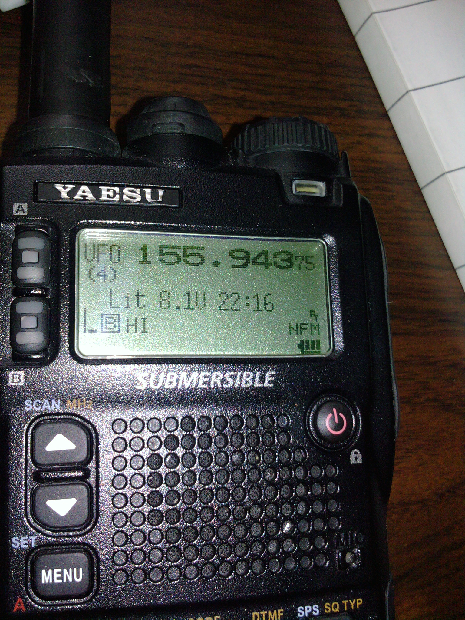

You can get to the frequency precision you need on the VX8 radios by changing the step to 6.25. When you do that, the radio will display the extra digits in a smaller font to the far right of the main digits. I also think that's a typo in RadioReference because that frequency just doesn't sound right. I bet it's supposed to be 155.94375, which you will be able to punch into the VX8

Moleculo- thanks for the suggestion to go to 6.25khz steps. That did let me put the freq in as you did at 155.94375
