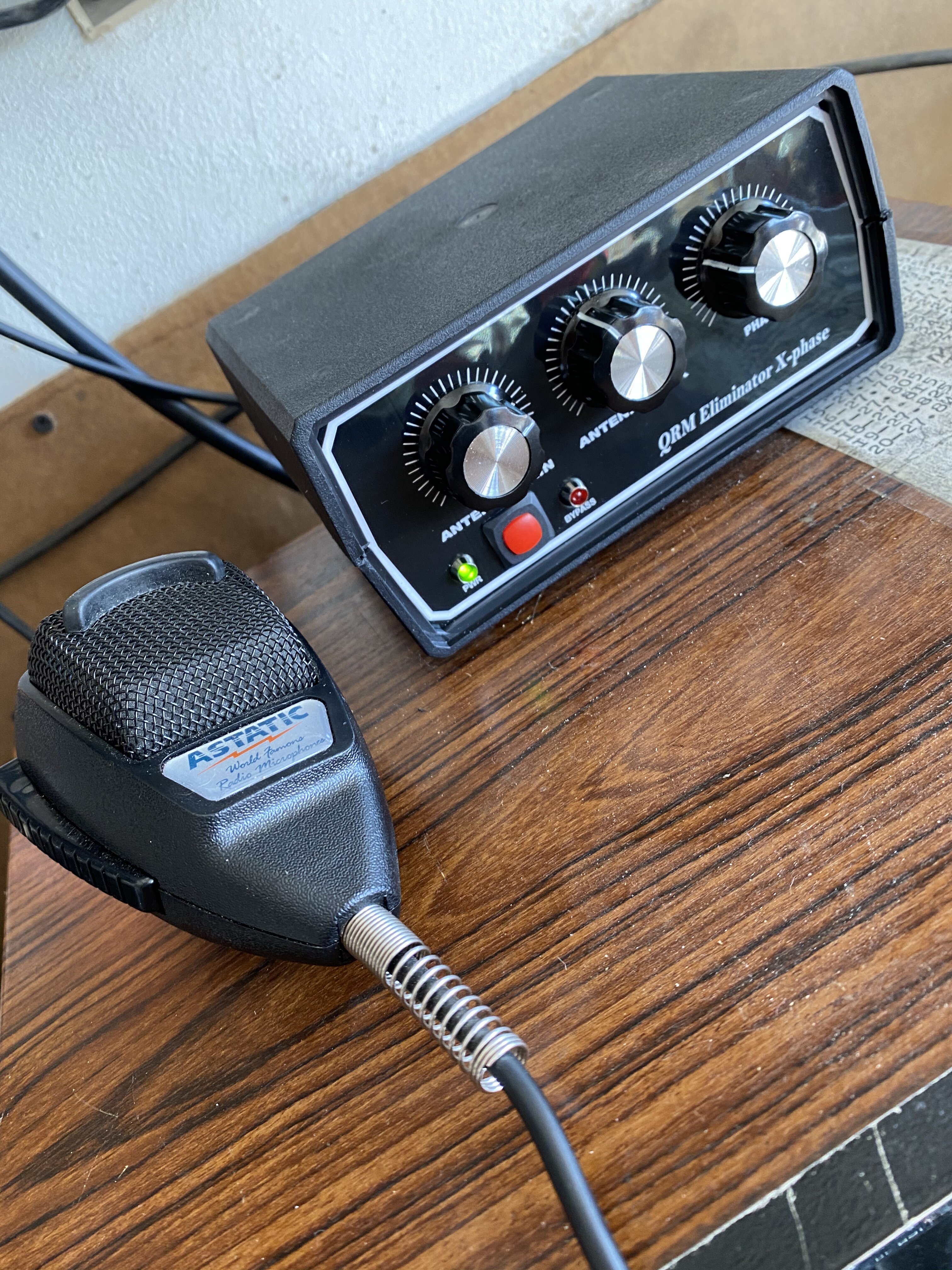

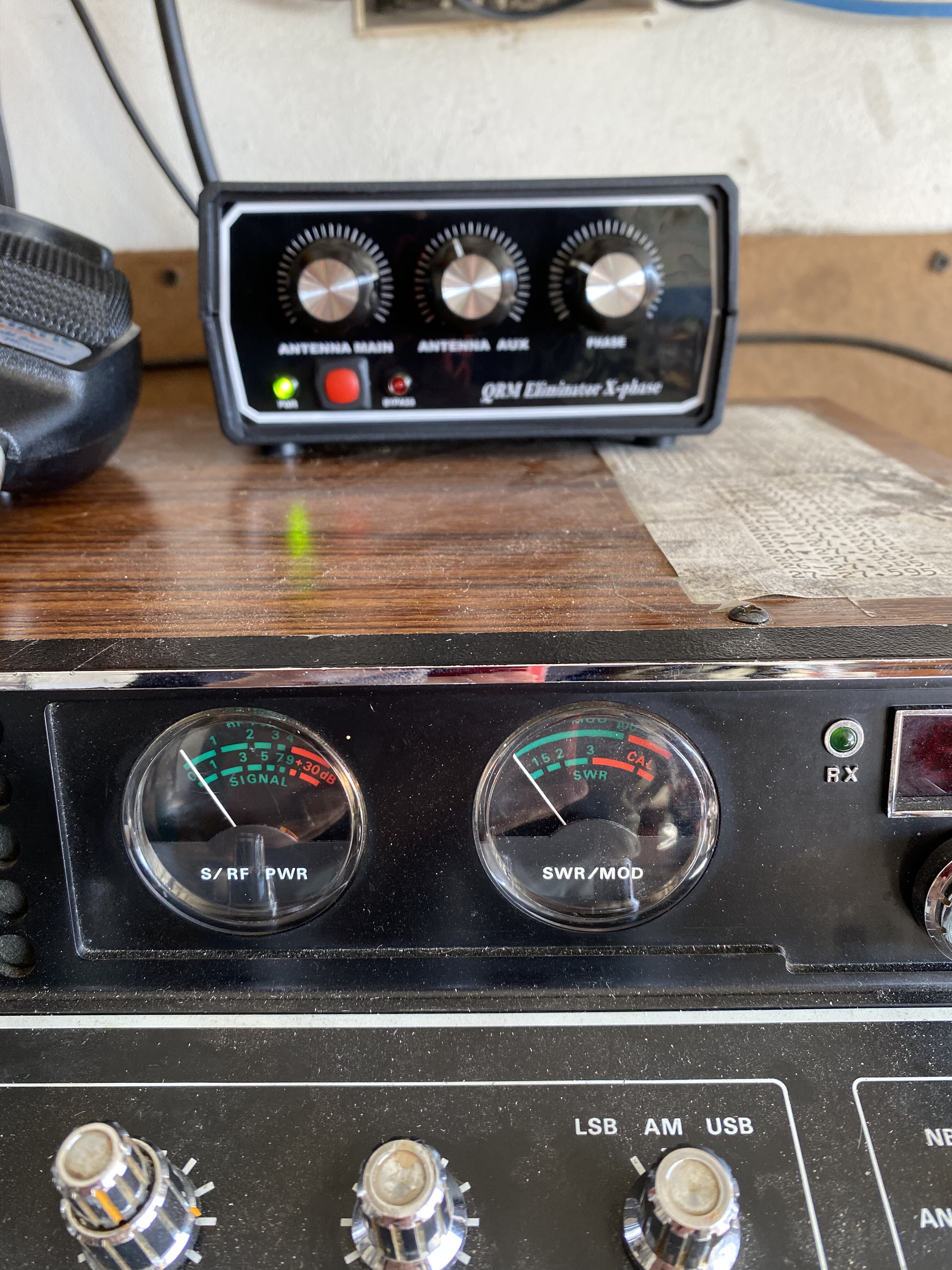

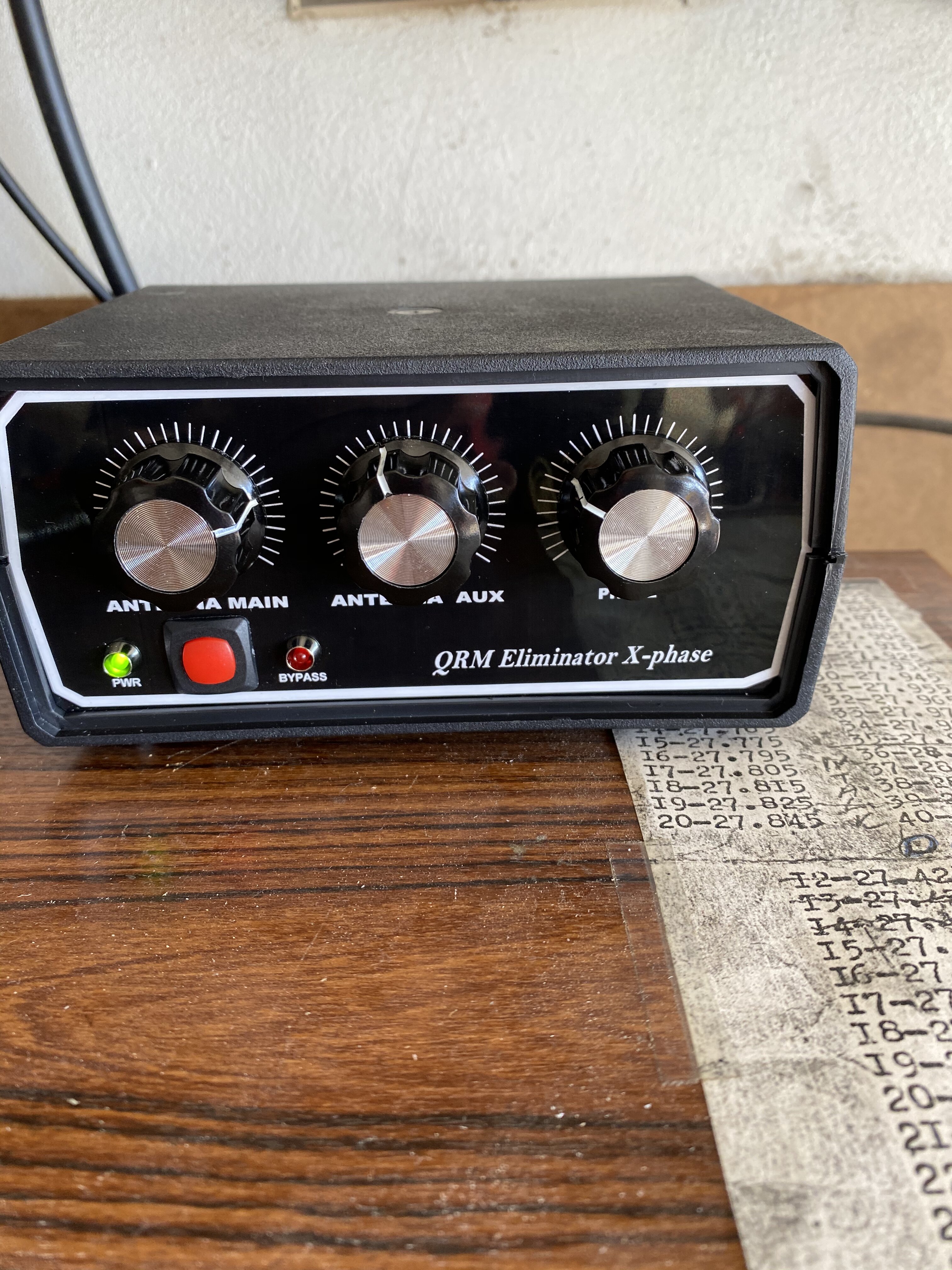

Man, work and life has kept me away for a little while. Thought I’d update this. I ended up buying one from a Ham in Ukraine of all places off eBay. It’s a pretty stellar unit. It feels kinda cheap(light and plastic). But I wanted a unit that has RF sensing for transmit and this one looks like it belongs on top of this old cobra. As you can see, the qrm has been reduced to almost zero. (Yes the radio is on in that photo!) I think it was 60 bucks. For my sensing antenna I ran a 18 foot coax out of my pops garage and hooked it to an old Francis Amazer we had laying around.
