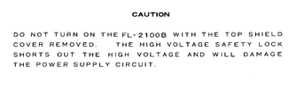

Do you mean inside of the amp? I'm assuming that's were it is If I apply power with the cover off it will blow the fuse I think. I really apricate the reply.
