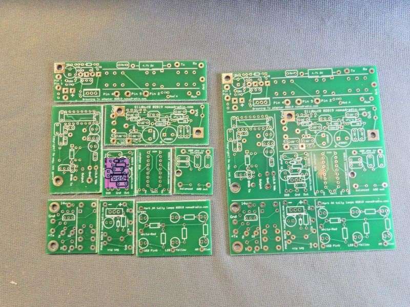

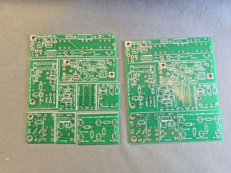

But the real subject of interest is how to keep down the unit cost of small circuit boards. Any of these can be made on a piece of Rat-Shack style perf board. The labor to do it that way costs a lot more, naturally. That's the point of these boards. Reducing the labor to build stuff our customers keep asking for.
Here's how to keep down the item price of small circuit boards. Cram them onto one larger board, and cut them apart.
This does require eight cuts on our sheet-metal shear for each one, to get the nine gadgets separated. For 50 boards, that makes 400 whacks of the shear.
What was that about saving labor? Yeah, it's a boring exercise, but still less trouble than the perf-board method all in all.
Everything's relative.
Got ten done. 40 more to go. Or is that 320 more to go?

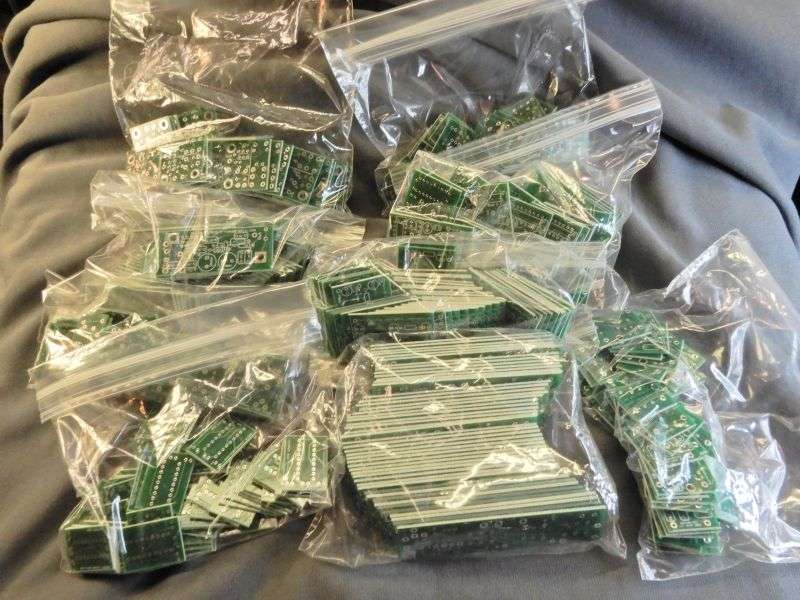

Gonna be busy getting 450 boards stuffed and soldered.
Never knew you could cut circuit with a sheet metal shear I figured it would break the green coating off the board. I learn something new every day.
First step after they're all cut is to build the "sample" unit of each, and get the parts for 49 more of that product into a sack for the assembler. Much easier to say "make it look like this one" than to write Heathkit-style instructions showing where each part should go.

As requested, here's one-ninth of the answer to "what are they for?".
This one gets built first because we ran out of them. Bad idea. Naturally this is the one I got asked about last week while I was waiting for the boards to arrive.
It's the one with the purple rectangle over it.

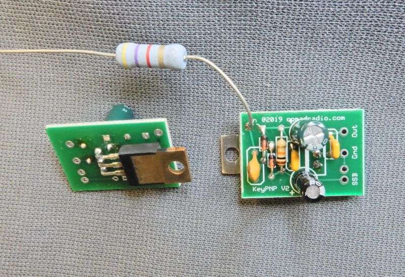

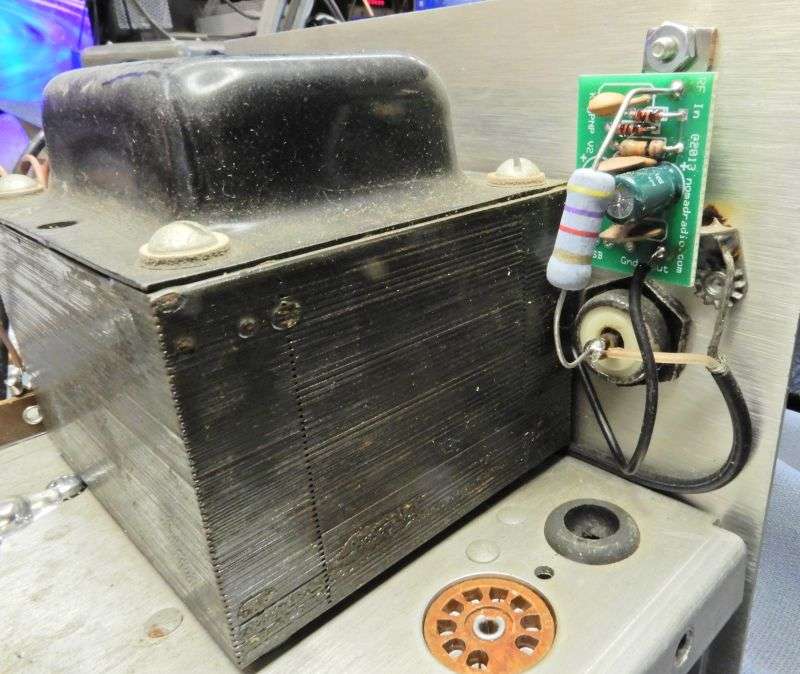

This is what it looks like assembled. It's the RF-keying circuit we use to replace the sorry versions we find in some old amplifiers. Biggest thing we use it for is in Maco and Varmint amplifiers that combined the preamp and keying circuit in one board. Removing the sorry-a$$ed preamp also gets rid of the original keying circuit. This one tends to perform better anyway, especially with the radio's carrier turned down.
The transistor's tab gets bolted to chassis ground, preferably near the "radio" coax socket. The 4.7k resistor goes to the center pin. A wire from the pad marked "out" goes to the relay coil. Couldn't be simpler. Unless you want a sideband delay. A wire from the "SSB" pad to the sideband switch, and the other side of the switch to ground takes care of that. Works fine with 12-Volt or 24-Volt relays.
The size of the transistor makes it pretty well universal. It will handle the coil current of even the biggest clunky relay. It's a darlington TIP125 transistor. Requires very little drive current to the base terminal to turn it on. Makes life easier for the two tiny diodes. They rectify a tiny sample of the radio's carrier. The tinier the better.
